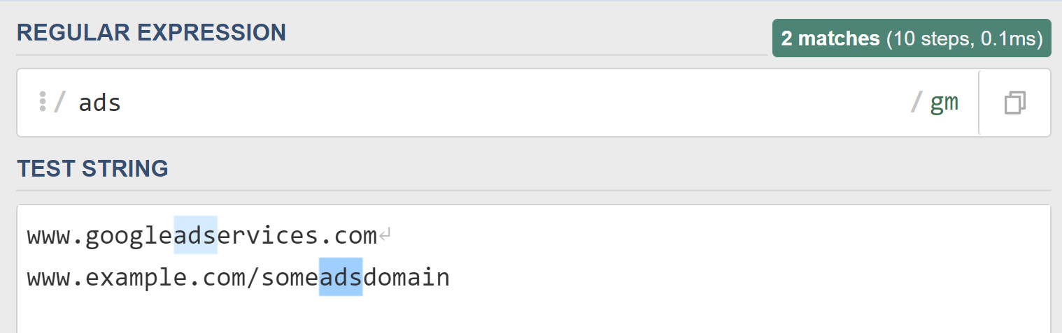

I have tried both the follow Regex entries:
  • ads
  • (ads)
But neither block even the most obvious requests (eg "www.googleadservices.com")

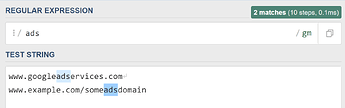

you tried ads and that should work, see regex101
