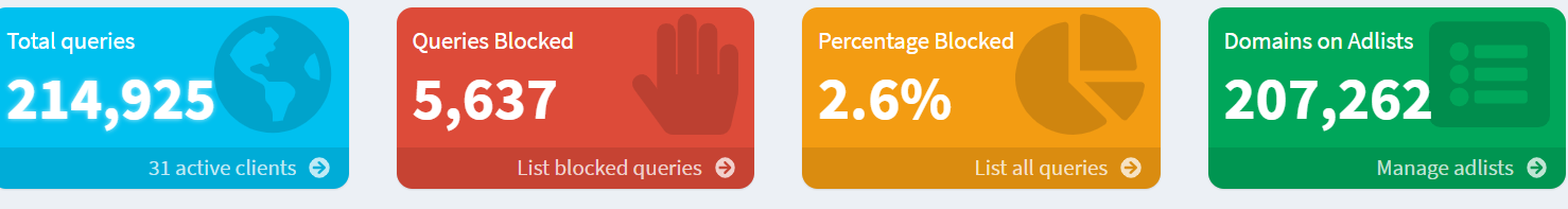

I understand all of that, but the thing is that the block rate is now 10x (at least) lower and there were no changes in the browsing patterns.
Something must have changed, but I can't put the finger on it (plus the perception I'm seeing more ads as usual

I didn noticed something, I have a process running 24/7 that is querying one my IoT local devices (1 req per second), and pi-hole shows a very high number of queries for that domain (tailing the logs I see a resolution per second for that name.
Currently I have 144914 queries today for which 76774 are for that name.
I've found this odd (should local domains be even accounted? (they are using Conditional forwarding) is there a way to ignore local domains?
Upon more investigation (the DNS for local domain is not the pi-hole) the TTL for this name is 1 day and yet pi is returning a 0s TTL.
So no wonder pi is getting pounded with that query.
Is there any way for pie to respect the TTL for local domains? Those can be perfectly cached

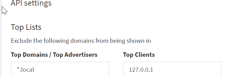

I've tried to ignore both *.local as well client 127.0.0.1 in setings->api/web interface and now the local domain no longer shows in the top domain list (nice), however those queries are still being accounted in the total queries...
Is it case the case, the counters are not recounted to eliminate the ignored domain?, so I will have to wait until tomorrow? (That is perfectly fine by me)
