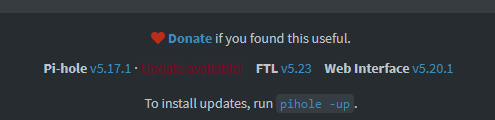

Hello
I'm on Pi-hole v5.17.1 and there is an update available
but when I try to update, it says it's up to date.
internet is working and I tried several times.
pi@raspberrypi:~ $ pihole -up
  [i] Existing PHP installation detected : PHP version 7.4.33
  [✓] Checking for git
  [✓] Checking for iproute2
  [✓] Checking for dialog
  [✓] Checking for ca-certificates
  [i] Checking for updates...
  [i] Pi-hole Core:     up to date
  [i] Web Interface:    up to date
  [i] FTL:              up to date
  [✓] Everything is up to date!
pi@raspberrypi:~ $
am I missing somthing here?

The web admin dashboard will lag the actual versions. The version shown on the dashboard isn't checked in real time.
I see,
but 20 hours is a bit mutch :wink:
np now I kwow this for the future,
I think the api also is lagging.
The command
pihole updatechecker
and a reload of the Pi-hole web page will bring it up to date.

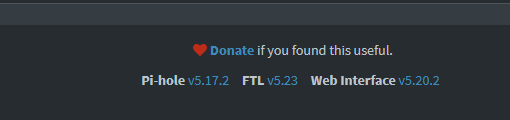

I had the same problem.
This fixed it:
cd /etc/pihole
sudo mv versions versions.bak
In case it's of any use in identifying the root cause here is a dump of my "before" (versions.bak) and "after" (versions) files:
t95x@aml-s9xx-box:/etc/pihole$ ls -l versions*
-rw-r--r-- 1 root root 325 Nov 10 09:58 versions
-rw-r--r-- 1 root root 650 Nov 10 09:55 versions.bak
