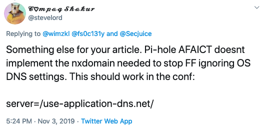

See attached tech-note from:
https://www.secjuice.com/encrypting-dns-for-privacy/
whose tutorial doesn't work for me and references firefox issues with DoH and pihole.
This was written in Nov 2019. On Feb 25, 2020 Pi-hole 4.4 was released that correctly implements the canary domain.
