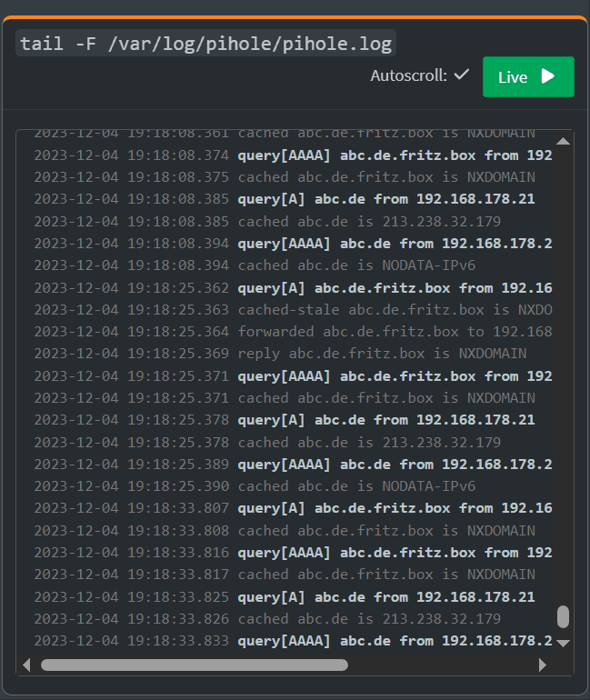

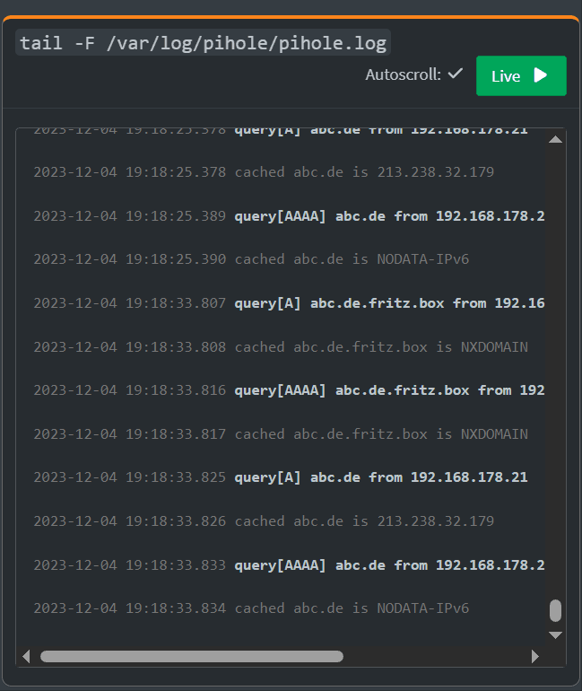

TheME
December 4, 2023, 6:45pm
27
This makes the red line width work as expected.
But then every second line is left blank.
Same display on PC and on smartphone.
Looks like with display: grid there is no need for <br> between the <span> elements.

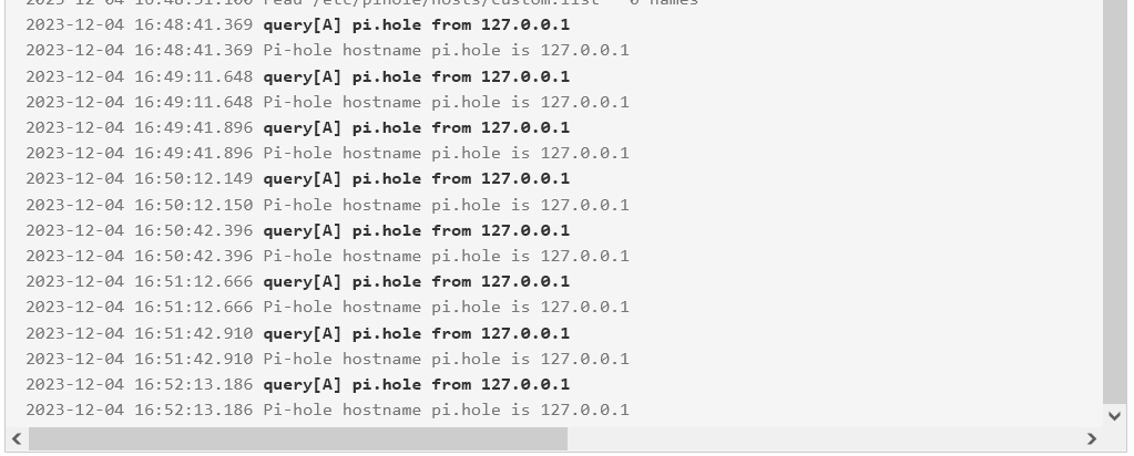

Thanks.
I see the same behavior in Chrome and Edge. I'm trying to fix it.
The most strange part - this doesn't happen in Firefox:
