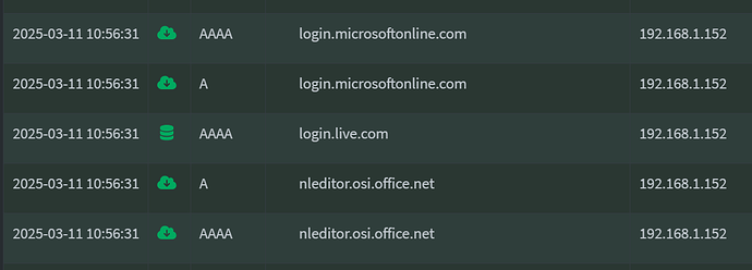

Can you send a picture of some sample queries? Specifically looking for the IP addresses of the clients.

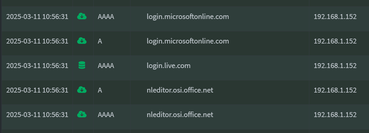

Have the pihole exposed now and fielding requests. Turns out my Synology has both eth0 and ovs_eth0 interfaces; the first one isn't bound to an IP, the second one is. Had to use that interface name.
Now, back to getting resolution working for local IPs...
What I'm after is to get that 192.168.1.152 to actually resolve to the device name.

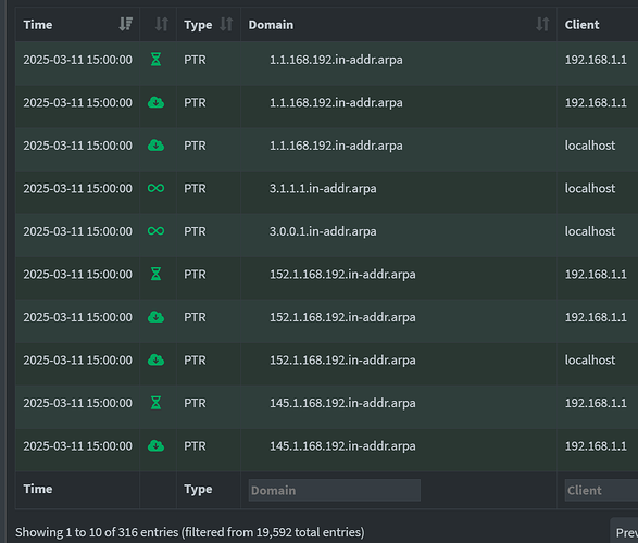

That's what I thought as well; added this conditional fwding value: true,192.168.1.0/24,192.168.1.1, no change - disabled "never forward reverse lookups for private IPs", no change.
1.1 is my router and DHCP server
Can you confirm that the pi-hole is asking your router for PTR records? You should be able to find them in the query log.
