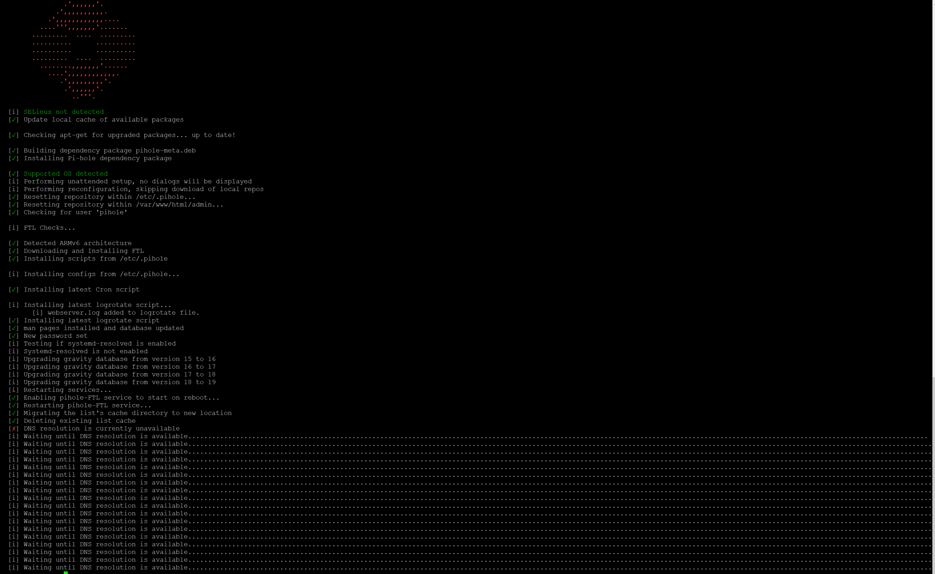

V6 upgrade - Endless loop - "Waiting until DNS resolution is available"
trying to update to v6, but stuck right at the beginning:

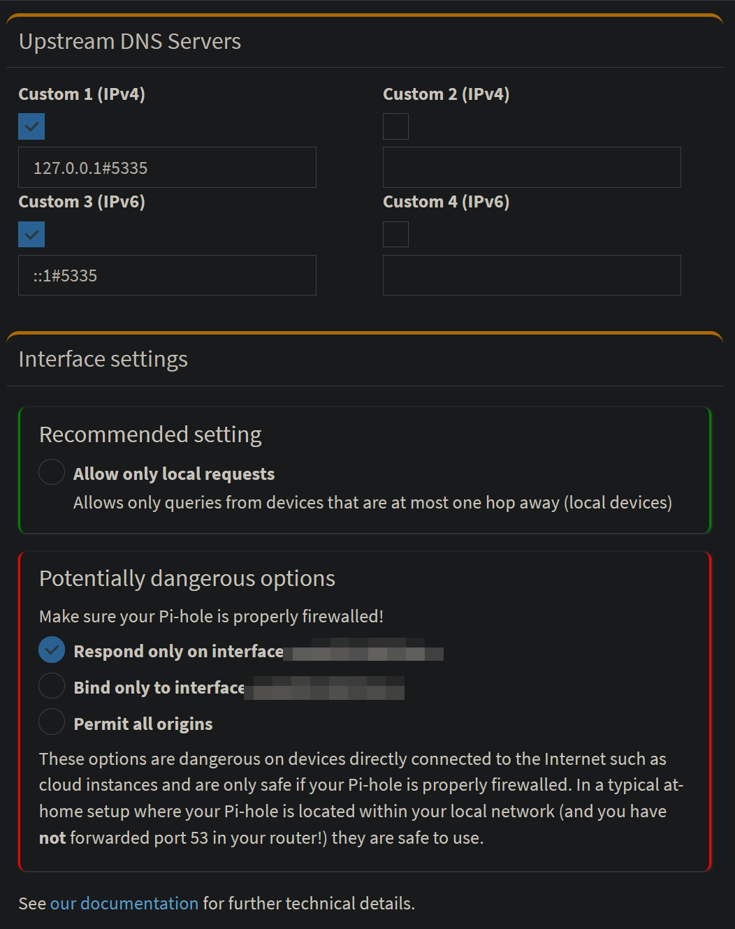

DNS setting original was:

This may happen if your OS isn't aware of a public DNS server.
If that 'Waiting until DNS resolution is available...' shows up for longer during installation, you could try to open another terminal session into your Pi-hole machine and edit /etc/resolv.conf to point to a public nameserver , e.g. nameserver 9.9.9.9.
Shortly after, you should then see the update process continue.

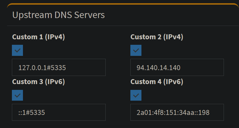

does pihole use custom 2 and custom 4 use as fallback if custom 1 and custom 3 are not available?
You're showing Pi-hole upstream DNS servers now, which are completely unrelated and independent from your host OS's /etc/resolv.conf DNS configuration.
No.
Pi-hole will regularly probe all of its configured upstreams to elect the fastest responding one, and will prefer that until the next probe.
In such a configuration as yours above, you can expect unbound to lose the election to the public DNS servers from time to time if it hasn't cached a reply from a previous lookup, as recursion typically takes longer.
unbound should be your Pi-hole' only upstream, and it is enough to configure that as 127.0.0.1#5355 - and if you followed our unbound guide, unbound won't listen on IPv6 anyway.

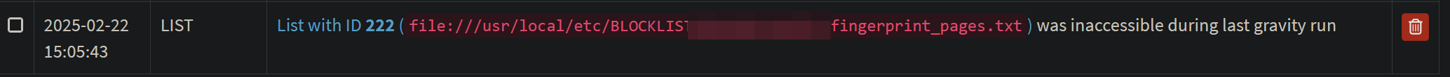

ok, seems to run so far, one question, how do I get the local lists back, previous setup is no longer working
file:///usr/local/etc/BLOCKLIST/..... doesnt grab a file system block list ...
local files are no longer recognized
ok, needed different permissions with v6.0:
dr-x--x--- 3 pi pihole 4096 Aug 19 2022 BLOCKLIST/
No. There is no fallback. All available upstream DNS servers may be used at any time.
