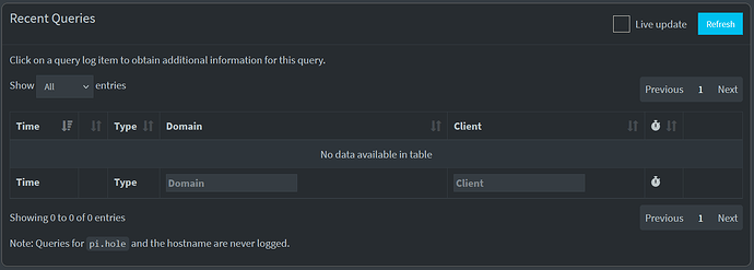

After updating to version V6.0.4, there are no entries in the query log.
As before with the V5 version, the entries are available to be able to understand what is blocked, for example.
The display is blank. This is from the beginning of the installation.
I have already deleted all browser data - no change.
A different browser does not display anything either.
This is shown in the FTL.log:

Hello together,
I have the following problem with pihole v6 (latest update).
When I switch the query log to show me β€žallβ€œ, the website hangs and after I reload I see no entries in the query log.
After deleting the pihole-ftl.db everthings works until I select β€žallβ€œ again.
So I can only viel β€ž10β€œ, β€ž25β€œ, β€ž50β€œ of β€ž100β€œ queres. The option β€žallβ€œ didnβ€˜t work.
