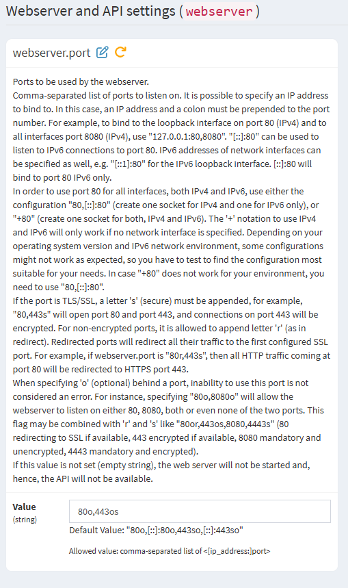

same here after updating to v6 the webinterface port changed from 80 to 8080 which is not possible because this port is used by sabnzbd. How can I change the port back to 80? even an reconfigure didn't helped its still using port 8080
https is wokring but I don't like the waring that the conneciton is not secure
found the settings under /admin/settings/all -> changed from 8080o -> 80o

When you can't access the webGUI but need to change things you can do the following :
# nano /etc/pihole/pihole.toml
and then look for the 80so,443so-like settings and change to the port you want :slight_smile:
Then it's just
systemctl restart pihole-FTL
and you got your webGUi back! :+1:

port = "8080o,443os" ### CHANGED, default = "80o,[::]:80o,443so,[::]:443so"
So I updated to:
# port = "8080o,443os" ### CHANGED, default = "80o,[::]:80o,443so,[::]:443so" port = "80o,[::]:80o,443so,[::]:443so"
Back to default...restarted the service and still not seeing the gui.
Will that not work?
I've also seen where you can add [::]: to the updated port numbers. That did not work for me either. So:
port = "8080o,[::]:443os"
Could you try just
port = "80o,443so"
And only test IPv4 connectivity ?
The other thing to note, I've disabled all IPv6. Do I need to enable?
EDIT: It worked, I'm in. Did not need to add :8080 or :80. Back to the old http://IP/admin/`

NOTE:
You don't need to add the port, when you are using port 80.
If you don't explicitly add a port, the browser will try port 80 because this is the default port.
