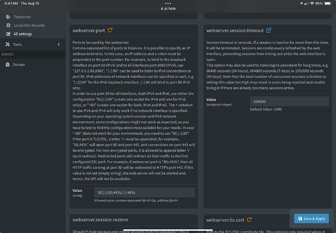

How long does it take for the v6 version to time out after logging in to the management page? Why do I have to log in every time? Compared to v5, it seems that there is no need to log in repeatedly if the service is not restarted. How can I set the login timeout in v6?
When browsing through "all settings" I found:
webserver.session.timeout
Is this what you are looking for?
Default is 30 min but can be changed in “All settings”.
OK, thanks.
Are the environment variables of docker-compose set as follows? Not effective
- FTLCONF_webserver_webserver_session_timeout=604800
You are using the wrong option (do not repeat webserver).
Try FTLCONF_webserver_session_timeout=604800.
