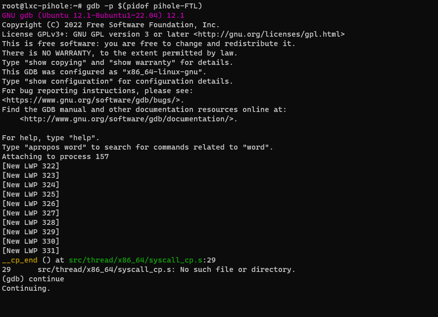

i'm running the beta in LXC (ubuntu server 22.04 LTS) and after some time it stops responding to DNS-Requests.
Are there any steps i can perform to provide you with more info than "it crashed"?

2023-10-12 15:10:29.744 [157M] INFO: Parsing queries in database
According to pihole-log this crashed somewhere around 09:20 +/- but according to pihole.log it responded after that
dmesg won't woirk here in LXC (unprivileged) - works on the host but there is nothing related to the instance itself. (which is lxc-2000, the 2001 named there is an unbound-install i started at the time again but is unrelated; pihole crashed somewhere yesterday without unbound-lxc running)

Not sure you'll be able to but it would be tremendously helpful if you could bring FTL into being watched by a debugger. We have a step-by-step guide written here: Redirecting...
You will have to bring gdb into your container, but this should be pretty straightforward given the instructions over there. The most important bit will be the backtrace you can get once the crash happens. From thereon, we can see together how to go forward. Maybe it immediately becomes clear when looking at the mentioned code.
I'll try :slight_smile: And it did crash 3 times since then, so shoudn't be a problem
Thanks for they reply, i'll start that right away
And now l'll wait :slight_smile:
Nothing so far apart from that:
this is normal, i think?
Yes, perfectly fine. gdb will drop to it's command line interface awaiting input on a crash.

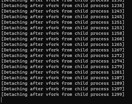

Great - it did not crash since running with gdb
It will eventually
ah, finally
[Detaching after vfork from child process 7401]
[Detaching after vfork from child process 7403]
[Detaching after vfork from child process 7408]
[Detaching after vfork from child process 7410]
[Detaching after vfork from child process 7415]
[Detaching after vfork from child process 7417]
[Detaching after vfork from child process 7423]
[Detaching after vfork from child process 7425]
[Detaching after vfork from child process 7433]
