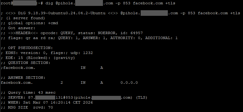

When using dig and DNS through HTTPS, I receive this return:

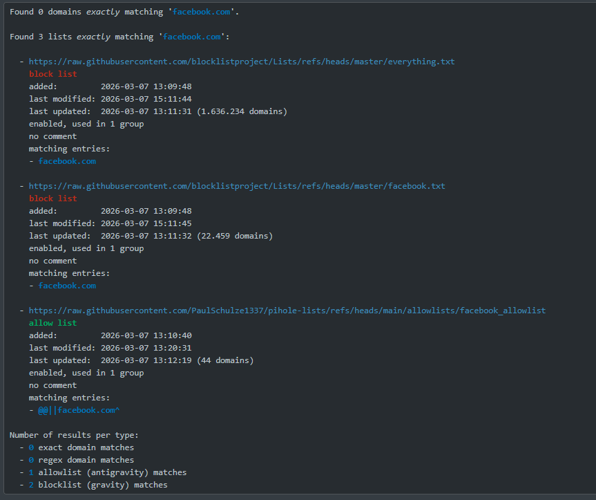

While these subscribed lists are relevant:

The relevant subscribed allowlist is processed as follows:
[i] Target: https://raw.githubusercontent.com/PaulSchulze1337/pihole-lists/refs/heads/main/allowlists/facebook_allowlist
[✓] Status: No changes detected
[✓] Parsed 0 exact domains and 44 ABP-style domains (allowing, ignored 0 non-domain entries)
Did I configure something wrong?

Thanks for the swift response.
The subscribed allowlist, which is supposed to allow facebook.com, is in this file:
The first valid line: @@||facebook.com^"
I wish to repeat that facebook.com becomes accessible if I am adding this line manually to my personal allowlist.

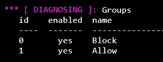

You are using the Group Management incorrectly.
You renamed the "Default Group" (ID=0) to "Block" and created another group called "Allow":
You also have no Clients assigned to any group.
The issue is:
Pi-hole will use the group with ID=0 and apply it to every client there doesn't have a group explicitly assigned. The other groups will be used only by Clients that are assigned to them (but there is no clients in your group management).
As a result, you Pi-hole is using all lists assigned to group ID=0 (Block), but is not applying the lists assigned to the other group.
If you want your allowlists applied to every client, you need to assign these lists to the group with ID=0.
Note: you should rename that group back to "Default", because adding allowlists to a group called "Block" will create a lot of confusion.
Your debug log shows that you have associated that blocklist with group_id 1:
*** [ DIAGNOSING ]: Adlists
 id    enabled  group_ids  type   address                                                                                               date_added           date_modified        comment
 109   yes      1          Allow  https://raw.githubusercontent.com/PaulSchulze1337/pihole-lists/refs/heads/main/allowlists/facebook_a  2026-03-07 13:10:40  2026-03-07 13:20:31
                                          llowlist
Yet you configured no client to be associated with that group.
And you only ever would have to add specific clients to groups if you'd wanted them to be filtered differently.
In your case, you should probably just re-assign your subscribed allowlists with Pi-hole's Default group (group_id 0), so all your clients would benefit from your allowlists.
