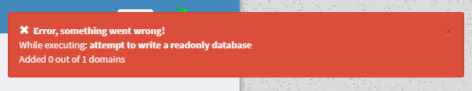

Running the most recent official V5.0 docker container.
When i try to add domains to the WhiteList, I get the below error.
I tried to chmod/chown the gravity.db and 777 on dirs/.db didn't solve the readonly error.
Still have 100gb free on my disk, so its no diskspace issue.
Tried a "pihole -r" and also "pihole -g -r" and a complety new config.
removed the gravity.db file, nothing seems to help/fix this.

just removed all v5 related from docker and the host, removed the "privileged: true" from docker_compose and did a clean docker pull.
After the pull I tried to add a domain to the whitelist, still getting the error;
https://tricorder.pi-hole.net/cufdubt8kd
I see a readonly error in the log.
On this clean install I ran the 2 sql commands;
root@pihole:/# sudo -u pihole sqlite3 /etc/pihole/gravity.db "INSERT INTO domainlist (domain) VALUES ('test.domain1');"
root@pihole:/# sudo -u www-data sqlite3 /etc/pihole/gravity.db "INSERT INTO domainlist (domain) VALUES ('test.domain2');"
Error: attempt to write a readonly database
root@pihole:/#
here's a log from after the 2 sql commands;
https://tricorder.pi-hole.net/ju0h27d9hj
I see only 1 whitelist test domain in the debug log, despite the 2 commands.
So the readonly error is really preventing it to write to the database.
Looks like gravity.db is now created with owner pihole;

So the privileged line is probably the cause of the root ownerships.
But even though the default ownership is fixed, I still get the readonly errors.
Last thing i did is run "pihole -g -r" and restart the container. Then I tried to add something to the whitelist, still getting the error and here's a log again;
https://tricorder.pi-hole.net/l6e5z9yz2p
I now see a bunch of readonly errors in the log.
If there's something I can do, let me know!

Ran the usermod command inside the docker container, tried the sqlite command, here's the result;
root@pihole:/etc/pihole# sudo usermod -aG pihole www-data
root@pihole:/etc/pihole# sudo -u www-data sqlite3 /etc/pihole/gravity.db "INSERT INTO domainlist (domain) VALUES ('test.domain2');"
root@pihole:/etc/pihole# sudo -u pihole sqlite3 /etc/pihole/gravity.db "INSERT INTO domainlist (domain) VALUES ('test.domain1');"
Error: UNIQUE constraint failed: domainlist.domain
again seeing the php errors;
-rw-r--r-- 1 www-data www-data 277 May 13 18:46 /var/log/lighttpd/error.log
   2020-05-13 20:45:14: (log.c.217) server started
   2020-05-13 20:46:13: (mod_fastcgi.c.2543) FastCGI-stderr: PHP Warning:  SQLite3Stmt::execute(): Unable to execute statement: attempt to write a readonly database in /var/www/html/admin/scripts/pi-hole/php/groups.php on line 507
[✓] Your debug token is: https://tricorder.pi-hole.net/rp48kg7wti
