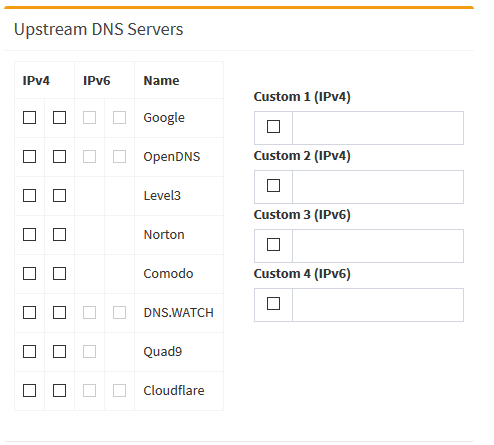

What are your upstream DNS servers currently set to in Pi-Hole? From the web admin > settings > dns page? The section of the page should look something like this:
Thanks for the reply! There are no settings selected on that page due to me configuring the pihole to use cloudflare's DNS over HTTPS. I configured that about a week ago and everything was working even with no upstream server selected. The steps I took to configure the DNS over HTTPS are in that link I posted. That may be the issue. Hopefully not though because DNS over HTTPS seemed like a cool (and more secure) configuration.
Your instructions have it setup on port 54, so it would be 127.0.0.1#54.
Note in the older versions of Pi-Hole, you could not have a custom port, so if you mapped it elsewhere in a configuration file, it would not have shown on the DNS server page. With the newer version (V4.0) of Pi-Hole it will display as a custom IPV4.

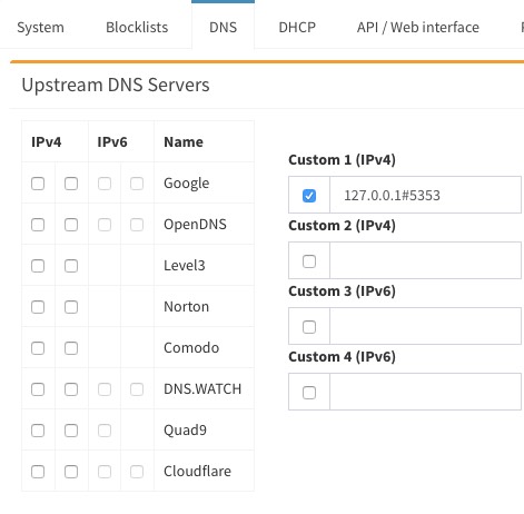

Here is what my screen shows using unbound as a local resolver on port 5353, for comparison:

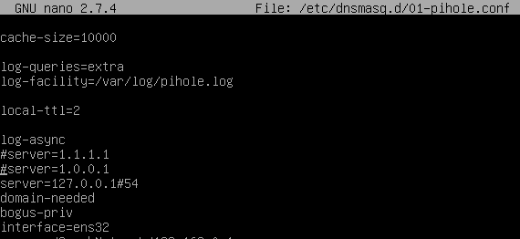

cat /etc/dnsmasq.d/01-pihole.conf

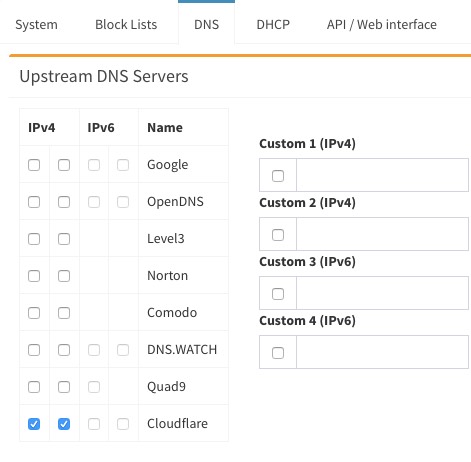

If fixing the server assignment doesn't work, I recommend that as a short term fix you select Cloudflare (at the bottom of your web GUI for DNS server settings) as your upstream DNS and see if that gets your Pi-Hole running again. May have to restart dnsmasq from the Settings > System page.
it's port #53 in my config.
Exactly I did have the configuration to go through a proxy on port 54, but that was set in the config files for pihole, not in the admin console. When I made that change all of the upstream servers disappeared. Perhaps it wasn't actually working and the blocking of domains was from the blocklist that was already loaded. Whats even more weird is the internet still worked. I was able to make this post connected to the pihole. I selected the cloudflare upstream dns and all is working again. I suppose the dns over https isn't working properly now though.

I reconfigured DNS over HTTPS and now everything is working as it once was, but the DNS settings page is still showing as nothing selected.
Here is my /etc/dnsmasq.d/01-pihole.conf entries, and like I said everything is working but not showing in settings:

Because you removed the first two upstream DNS servers, the script does not find the first server and therefore assumes there are no servers. Remove the commented out lines and change the 3 to a 1.
