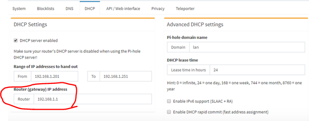

Screenshot from the pihole admin console:

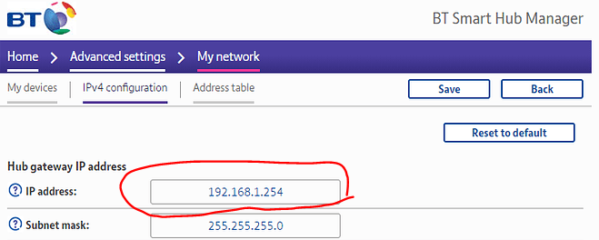

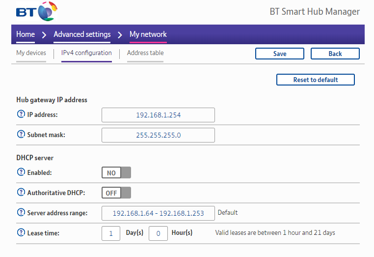

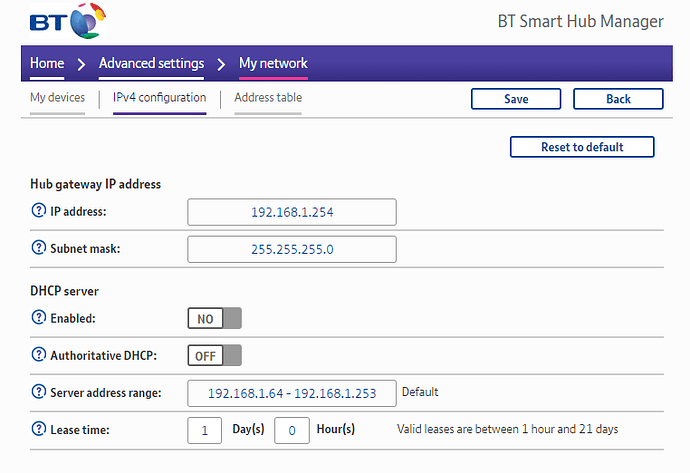

Screenshot from my router settings:

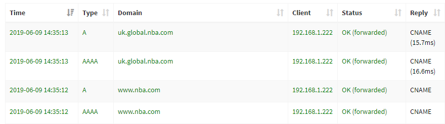

When you try to load other pages, are you seeing matching traffic from the client in the Pi-Hole log? This FAQ has a number of helpful tools to determine why desired content will not load. I recommend using them, and work with just one client at a time to simplify the troubleshooting.
Yes, I do see matching traffic in the logs, but the pages still aren't loading. It seems like something is going wrong with the DNS resolution. I'm not seeing anything in that article that would help with this particular issue. When i turn off the DHCP settings & reconnect to wifi then the page loads fine

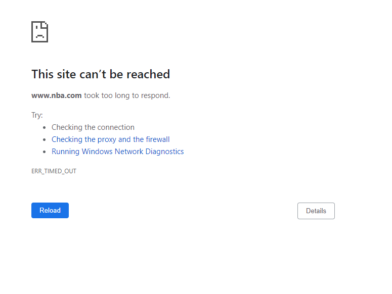

Chrome error page when I browsed:
From the Pi terminal, are you able to dig and ping these domains successfully? If yes, then the problem lies in the browser and its settings. Or, you may be blocking some element of the page that the page needs to load in your location (the referenced tools can help here). Have you tried an alternate browser? Have you cleared the browser cache and restarted the browser?

Yes, I can ping the sites from raspberry pi device. I tried this, but I don't think the problem is with the pi accessing the site; I think it's something to do with the DHCP setup. Here's an outline of what I've done--basically three tests that to me make it seem like this is a problem with the DHCP settings:
  1. Enable DHCP settings in pi-hole admin console
  2. Turn off DHCP settings on router
  3. Reboot pi, router, and desktop
  4. Connect to wifi on desktop
  5. Browse to rottentomatoes.com & page loads fine
  6. Confirm pihole is being used via query log
  7. Browse to nba.com & page does not load
  8. Confirm pihole is being used via query log
  9. Disable DHCP settings in pihole admin console
  10. Turn DHCP back on in router settings
  11. Restart wifi connection on desktop
  12. Browse to nba.com & it loads
  13. Confirm pihole is not being used in admin console
  14. Go to network settings on desktop, and specify pihole IP as DNS server
  15. Restart wifi connection
  16. Browse to nba.com & it loads
  17. Confirm pihole is used in admin console
Can repeat this ad nauseam with the same results

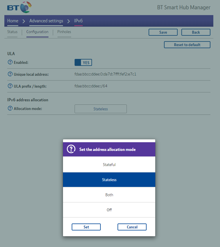

Sounds like only ipv6 traffic?
That seems like it could be the issue. The original screenshot I posted of my router settings was just for IPv4. This is basically all I have for IPv6... would any of these settings work? Or is it just not going to be possible on my router?
Shouldn't you use 192.168.1.254 as gateway address in below settings:
Wow, that was exactly the problem. Not sure why it was wrong in the first place as I never modified that, but thanks!!
