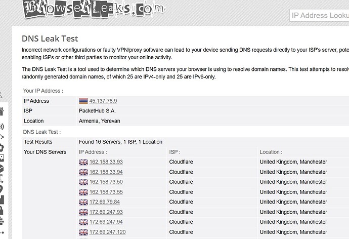

Out of curiosity I noticed that running DNSLeaks shows Cloudflare UK, Manchester servers from a device connected to NordVPN (Armenia with pihole as the DNS).

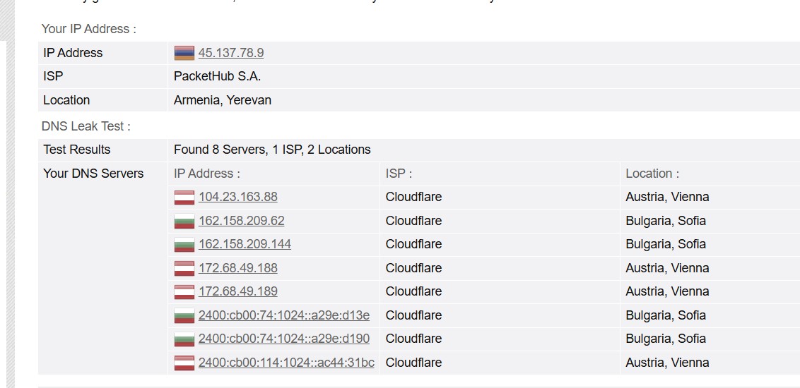

If I hardcode 1.1.1.1 and 1.0.0.1 DNS into say my iPhone or laptop running through NordVPN, the DNSleak results are as expected. DNS servers are no longer UK based:

Ultimately, I want to use NordVPN and DNS/ad blocking filtering from pihole but it looks like NordVPN is ignoring pihole DNS and thus Cloudflare upstreams creating a leak

Are they as expected though? Your VPN location is Yerevan in Armenia and CloudFlare is using DNS servers in a mixture of locations, non of which are Armenia.
Might this be an artifact of how CloudFlare distributes its load, and the Manchester servers just happen to have the best latency and/or capacity?
If you're able to reproduce the switch between them consistently then it looks real, in which case it sounds like the way the router handles various types of traffic, with its built-in VPN capability, or perhaps the way the router manages VLANs and the way you've got them set up, is not necessarily as expected.
Thanks Chris. But why would the pihole Cloudflare DNS be any different to hardcoded Cloudflare DNS in terms of where it pulls the name servers from? Same with Google. If I change piholes upstream to Google DNS it returns Nameservers in London. Seems like too much of a coincidence to me.

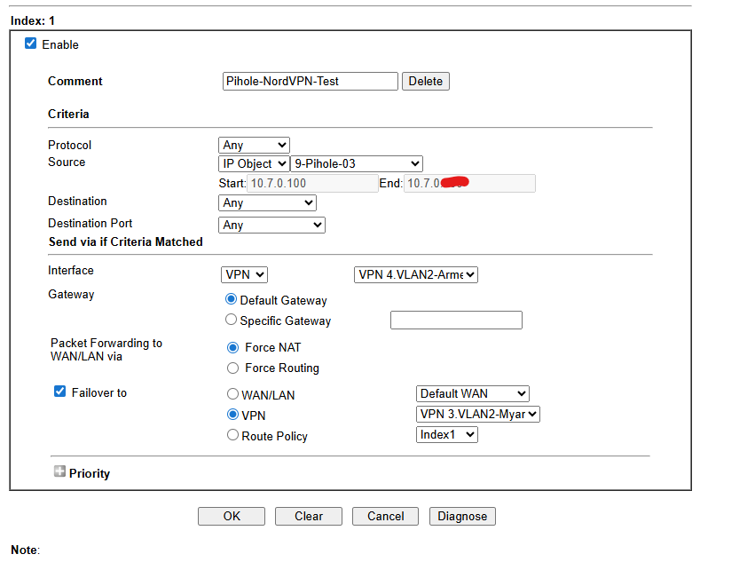

So I’ve added one of my ‘test’ piholes to a route policy in the router - directing to Armenia and Myanmar VPNs (failover):
For now i’ve set the protocols to ‘Any’
Source IP - Test pihole
Destination: Any
Destination Port: Any
Interface: VPN - Armenia
I’m not at home right now so can’t test - but if I point my device to the pihole above I wonder if it’ll work?

In aarbron's case, their router's policy based routing exempted Pi-hole from being forced through NordVPN, thus leaking its DNS traffic over public Internet. They have since added a route policy for their Pi-hole machine, directing it to use their NordVPN gateway with Armenia and Myanmar exit points, which would prevent DNS leakage.

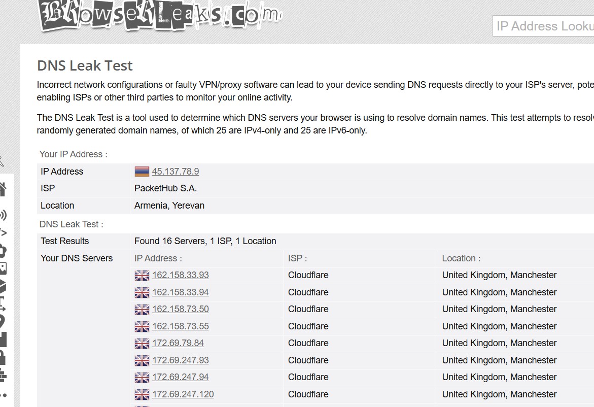

Out of interest, I changed the upstream DNS in pihole to Nords IPs and the result is as follows:
@Bucking_Horn - I tried routing pihole via a route policy to NordVPN in the Draytek router but that kills all connections to Pihole from any devices that are pointing to its DNS and the pihole becomes unreachable.
