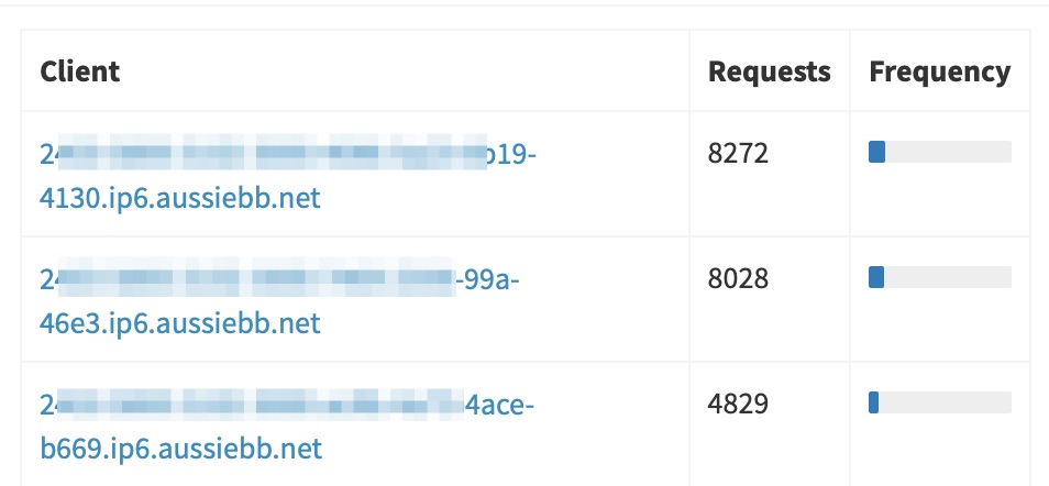

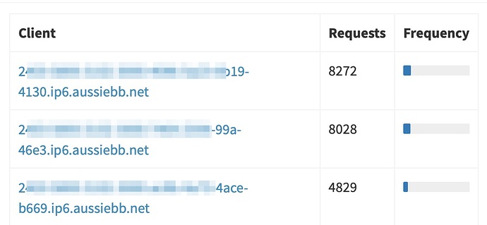

Using pihole as DHCP server but ipv6 address showing in logs
I've set pihole as the DHCP server, and I see the IPv4 address and associated hostname being shown in the web interface.
I would expect that these host names would also show in the Query Log and Dashboard summaries.
But the ipv6 reverse dns address is being shown rather than host name
Is there a way to have a host name that's associated with the ipv4 MAC address to be shown in the logs?

As far as can be assumed from your screenshots, you are seeing the correct generic public hostnames for your devices' public IPv6 addresses rather than reverse IPv6 addresses.
Your ISP is operating the authoritative DNS servers for your public IPv6 addresses (range 2000::/3), and may well use such an address itself to construct a generic name.
