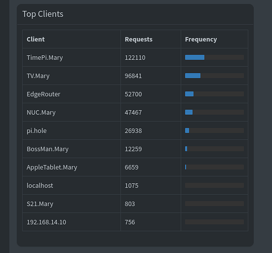

If I look at the reports any machine on THIS VLAN I see the name.
Machines on other VLANs only get their IP addresses.

Though there is this one rogue machine.
I may need to look at that a bit more.

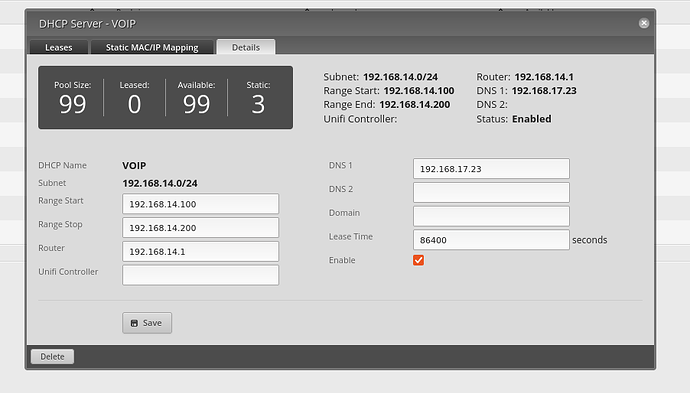

Update on the 192.168.14.10:
That is how the other VLANs are the same for how they are set up.

Thoughts on what is going on with those 2 pics?

I'm not sure I can set a machine name on that software.
Maybe that's the cause?
Could be.
If the client does not present a hostname during DHCP negotiation, and your router does not allow you to assign one, you could create Local DNS records for it.

The first picture (of the two above) shows the DHCP page and the IP address is assigned a name there.
