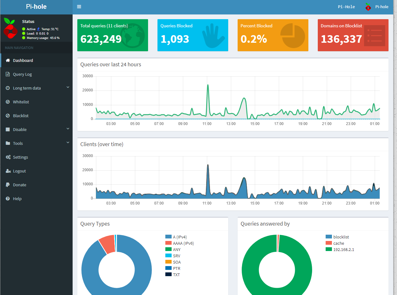

followed this guide here along with support from PIA to get the VPN on my router, but I think my router just isn't fast enough to do the encryption so my net was slow and I just abandoned it. I've got my my pihole setup connected to my router anyway so anything not using the VPN app is still using it, eg;
