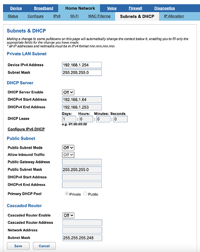

Using Pi Hole with AT&T U-Verse as the DCHP sever. There are duplicate leases in Pihole and AT&T, ads still being served. Help!
I have AT&T U-Verse and unfortunately have to use the Arris BGW210 so I can't edit DNS settings. So I'm using my Pi Hole as a DHCP server. I have DHCP disabled in AT&T and set up on my PiHole.
  • Ads are blocked on Macbook Pro, iPhone etc.
  • Devices show up only on the DHCP lease list in the PiHole console, not in the AT&T device list as well.
  • My devices show up in both the AT&T device list, and the PiHole DHCP lease list, but with different MAC addresses and IPs.
  • Ads are still shown on all devices. Even though I'm using /u/Wally3k's lists as well as the default, the dashboard shows only 81 blocks, 0.3% of total requests. Sites like nytimes.com have tons of ads on my MBP as well as my iPhone.

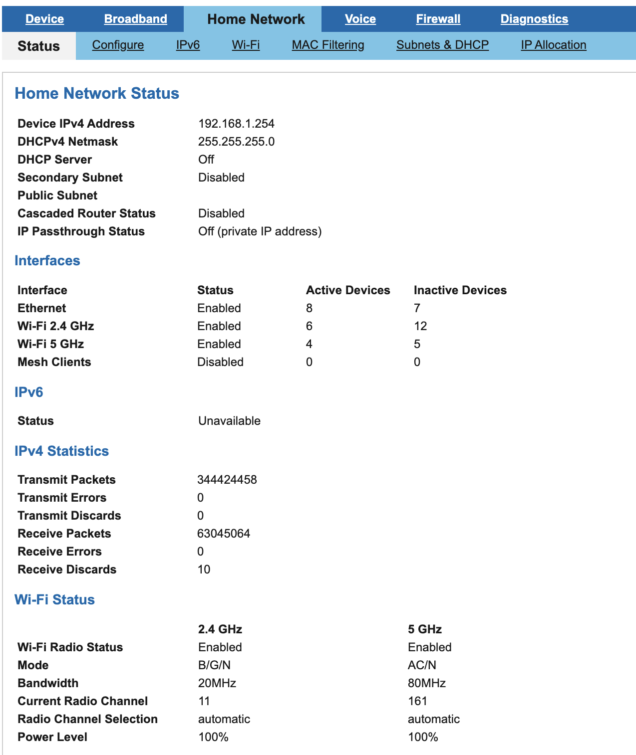

The below photos show my settings in AT&T.

I repeated the shut down & reset procedure one more time, and lo and behold its finally working! The restart procedure for the AT&T device is pretty weird and misleading, I had to log in/enter the device pw three times and it wasn't clear when it was actually restarting, so its possible I previously thought I restarted it when I hadn't.
