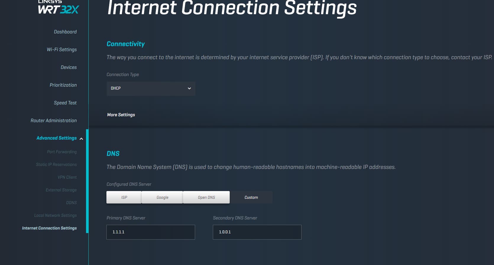

The router that seems to be my gateway (192.168.1.1) is a linksys wrt 32x and this is the page
. Should I try putting the pi's IPV6 settings over on this routers page under connection settings? I do not see an option for IPV6 or anything related. I have two routers though set up on my network. I believe 168.1.1 is just an extra access point.
I'm assuming by having two "gateways" 168.1.1 and 168.0.1. Maybe IPV6 is enabled on the first router, over on 168.0.1?
(I might just have to share this thread to the person who owns the routers and may know them better, they gave me access I just don't see an IPV6 DNS option or an option to enable or disable on the linksys)
