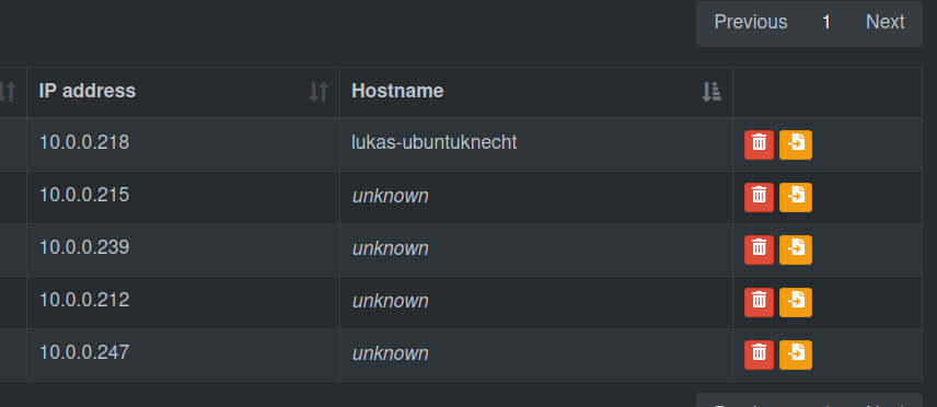

Thank you for your answer. Attached is a screenshot of the section "Currently active DHCP leases"
I just removed the Mac addresses in the beginning.
The outputs are like this, 2 of the unknown and the known one:
➜  ~ nslookup 10.0.0.215 10.0.0.1
** server can't find 215.0.0.10.in-addr.arpa: NXDOMAIN
➜  ~ nslookup 10.0.0.239 10.0.0.1
** server can't find 239.0.0.10.in-addr.arpa: NXDOMAIN
➜  ~ nslookup 10.0.0.218 10.0.0.1
218.0.0.10.in-addr.arpa	name = lukas-ubuntuknecht.lan.
