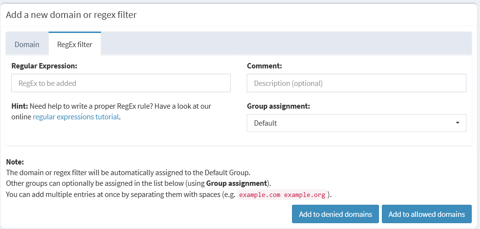

Add the entry as a regular expression:
(\.|^)spectrumvoip\.com$

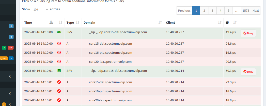

You didn't post the screenshots showing the blocked rows. What exactly the "Query Status" field shows?
Sorry. . . I am very busy and just haven't had time to go back to that project after I had to pull it back out and reconfigure everything to get my students and staff back online. . .

Is this the screenshot you wanted?
Thanks again for your help!

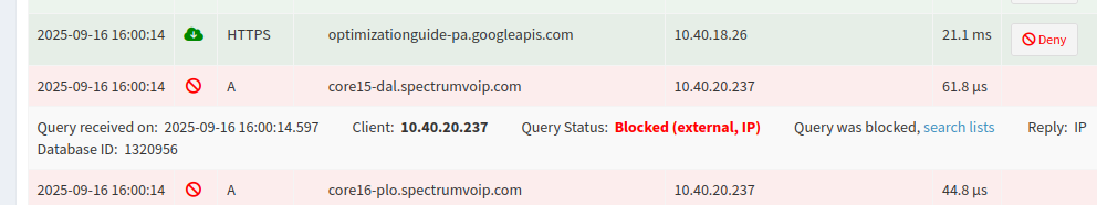

Not exactly. You need to click on the rows to expand them and open the details.
I need to see what is shown in the "Query Status" field: image
Does it show Blocked (gravity)? or Blocked (external)? or something else?
Try this one. . .
It does show blocked (external,IP) but it isn't blocked externally because the phone works fine until run though PiHole.
What does it mean when it says "Query Status: Blocked (external,IP)? The phones get their IPs the same way as everything else even though they are assigned by reservation. But that shouldn't matter. They work until PiHole is added as their DNS.

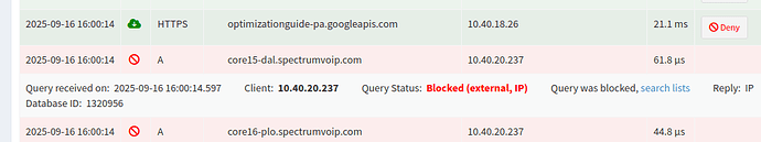

Blocked (external,IP) means Pi-hole is not blocking the query.
Pi-hole is sending the query to the upstream server, but the upstream DNS server is blocking it.
This is not true.
Is your phone using the same DNS servers you configured in Pi-hole (10.40.16.6 or 10.40.16.7)? Probably not...
When you set Pi-hole as DNS server, you are actually selecting Pi-hole and also its upstream DNS servers and these servers are probably different than the server used by your phone.
Pi-hole is not blocking the domains, then it will ask for the upstream server to answer "what is the IP of core15-dal.spectrumvoip.com?".
If the upstream server blocks this domain, no IP will be sent and there is nothing Pi-hole can do about.
