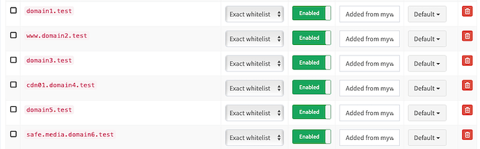

Here is a script which will let you add your own whitelists of domains in hosts format.
#!/bin/bash
while IFS= read -r domain; do
  domain=$(echo $domain | sed -e 's/^.*\s//')
  pihole -w -nr --comment "Added from $1" "$domain"
done < "$1"
pihole restartdns reload-lists
Call it, eg whitelist, put it in your pihole home directory and make it executable (chmod +x whitelist). Run the command with a whitelist of domains in hosts or list format. Eg (showing the three common formats),
$ cat mywhitelist.txt
domain1.test
www.domain2.test
0.0.0.0 domain3.test
0.0.0.0 cdn01.domain4.test
127.0.0.1 domain5.test
127.0.0.1 safe.media.domain6.test
$ ./whitelist mywhitelist.txt
  [i] Adding domain1.test to the whitelist...
  [i] Adding www.domain2.test to the whitelist...
  [i] Adding domain3.test to the whitelist...
  [i] Adding cdn01.domain4.test to the whitelist...
  [i] Adding domain5.test to the whitelist...
  [i] Adding safe.media.domain6.test to the whitelist...
  [✓] Reloading DNS lists
