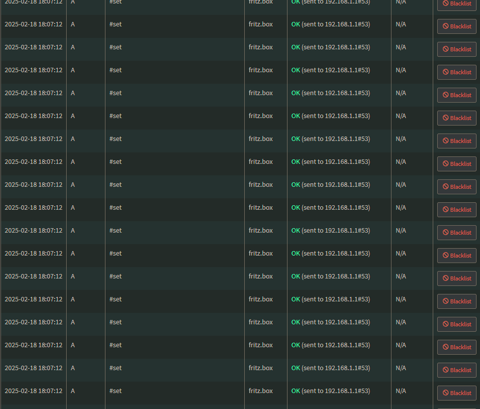

I'm also getting
Warning in `dnsmasq` core:
Maximum number of concurrent DNS queries reached (max: 150)
Check out [our documentation](https://docs.pi-hole.net/ftldns/dnsmasq_warn/) for further information.
which seems related to the conditional forward although i'm not sure whether this is because a dns loop (!?)
This is what i see
I am taking a stab in the dark here, but often the Maximum Concurrent DNS Queries issue is cause when you have Conditional Forwarding set to be the IP address of your router, and the router has its WAN DNS settings to be the IP address of the Pihole device.
You should typically only use the IP address of the Pihole for LAN (or DHCP, depends on hardware) DNS settings. This is the information your router will provide to client devices on your network for where to get DNS information; the WAN DNS tells the router where it (and only it) will go for DNS resolution. This almost always should be a public DNS server like 1.1.1.1, 9.9.9.9 or 8.8.8.8.
If you are using Conditional Forwarding, you should not have your router (WAN) DNS pointing back to the Pihole, or you'll create a loop and this error occurs.
There are other conditions that can cause this, but the above is pretty typical when folks are trying to get set up.
I'm definitely in the scenario you are describing.
I've come across this Pi-Hole setup with a FritzBox! · GitHub which seems to have resolved the warning although it seems my dns records are not getting updated (? i need to test a bit).
Does that mean that my WAN DNS cannot pass through the pihole? is there any downside to that?
Look at it this way: the only thing that will be using public DNS queries will be those your router makes directly (as in, the operating system running on the router). What are the chances it will try to go to a rogue DNS for queries? All it will do is make queries to verify it's connected to the Internet and occasionally check for firmware updates.
