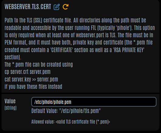

By default Pi-holes certificate is located at /etc/pihole/tls.pem.
You can change the certificate in the Web Interface at:
Settings < All Settings < Webserver and API < webserver.tls.cert in Expert Mode
The file has to be in .pem form (like mentioned in the description) and be readable by the user pihole.

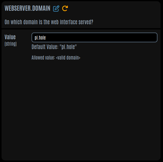

When using a different domain name than pi.hole its recommended to change webserver.domain as well.
(Also at Settings < All Settings < Webserver and API)
I did that. I put my new cert into
/etc/pihole/pihole.pem
I then changed that in the UI as you pictured above.
I then changed the webserver.domain to the correct value.
