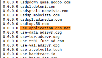

Last week, I noticed use-application-dns.net is on a blocklist.
When firefox does the query, to check if it can use DoH, the reply is 0.0.0.0 (BLOCKINGMODE=NULL), as opposed to the required NXDOMAIN reply. The blocklist entry appears to have precedence over the 'server=/use-application-dns.net/' setting, that was added last year to /etc/dnsmasq.d/01-pihole.conf.
