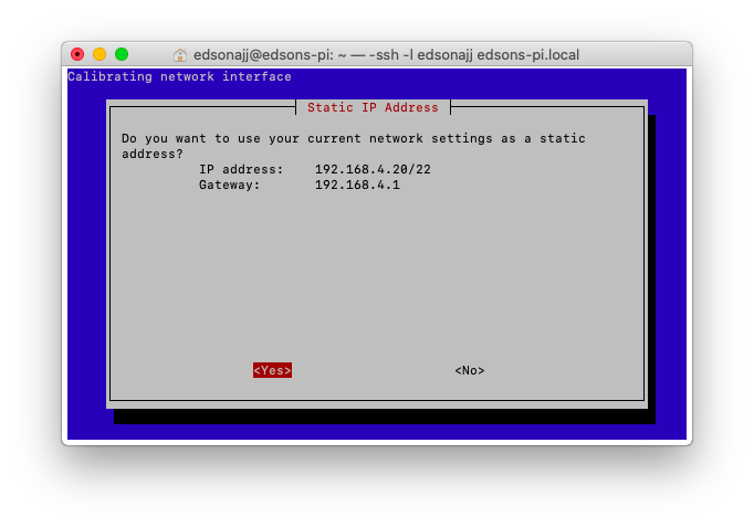

Being able to set a local network IP with the block set as “#.#.#.#/22”, since that is what my router seems to use as detected during Pi-hole installation.
The “/22” block is rejected by the pinhole web interface when trying to use conditional forwarding.
My router seems to give out addresses within the “/22” block, this in itself is detected during the Pi-hole install process.
However, when trying to set that same block for conditional forwarding it gets detected as invalid and the men interface discards it telling me to use either /18 or /24.
Does anyone know how I can set up the correct subnet or if a chang is needed with it the Pi-hole code?
