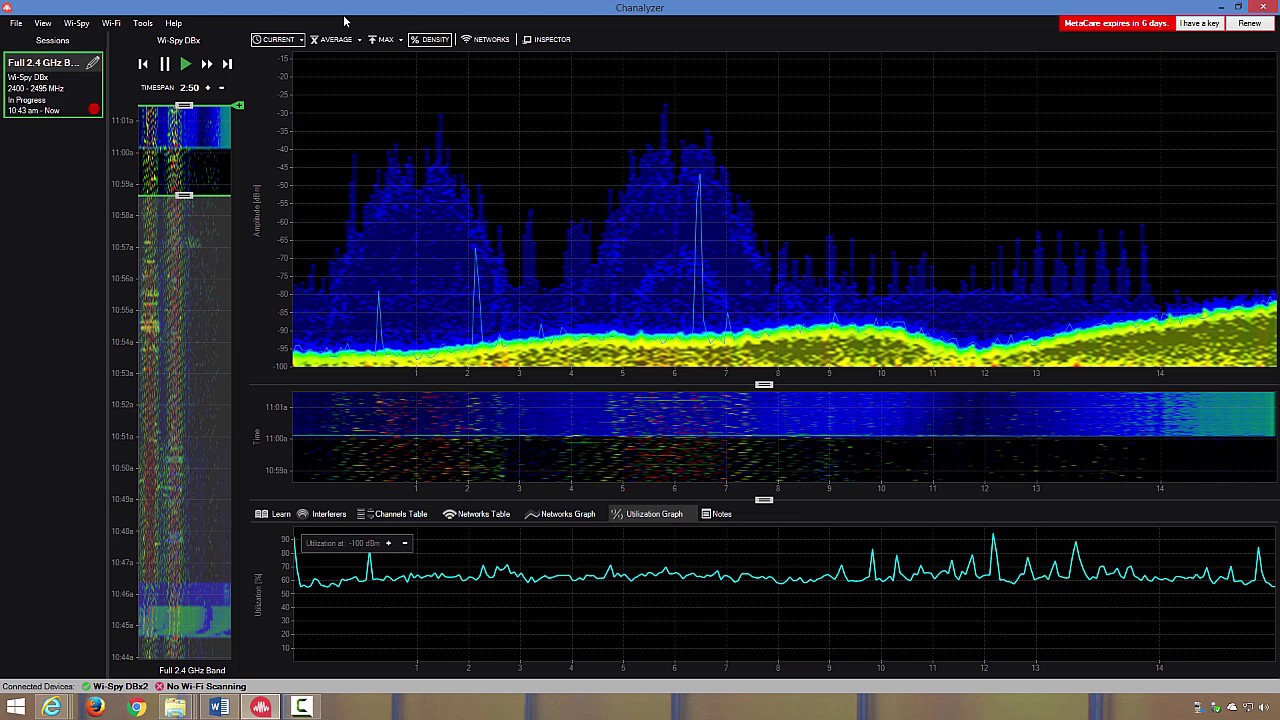

Standard USB-Sata cable employed but once the SSD was plugged into USB 2.0 the interference just went and I can see that it’s gone on the router’s GUI/spectrum display.
The RFI impacted only 2.4Ghz WiFi on the dual band router. My phone has only 2.4Ghz so couldn’t connect. It can now the issue is solved.

This video helps to explain how USB3.0 impacts 2.4Ghz wifi.
