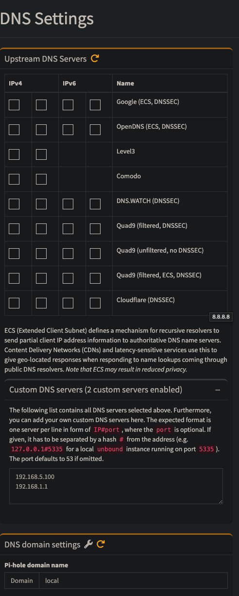

I have the retro PiHole instance set as an upstream DNS server on the internal one, hoping I could use that to look up local hosts on the retro VLAN from the internal, without having to duplicate the entries - but it doesn't seem to try to query the upstream for queries that it doesnt find.
This is the upstream config on the internal:

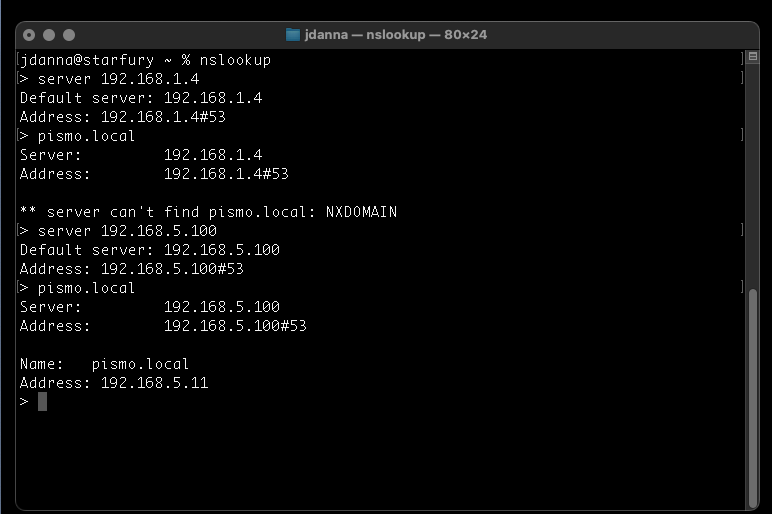

And this is the difference when I query a host on the internal vs the VLAN instance:
Is there a way to tell pihole to check the upstream server any time a host isnt found?
I think you have 2 options :
  • Setup Conditional Forwarding from the Main Pi-Hole to the Retro Pi-Hole
  • Enable Forwarding Local Domain Extensions to the Upstream Retro DNS Server
But...
IMHO the best is to have just 1 Pi-Hole with some VLAN Interfaces on it and bind only FTLDNS to all of them while keeping the WebGUI only on the Main eth0 Interface :slight_smile:
I have been doing that for years and it works very well :+1: :+1:
Ah perfect - i think conditional forwarding is perfect for what i need.
