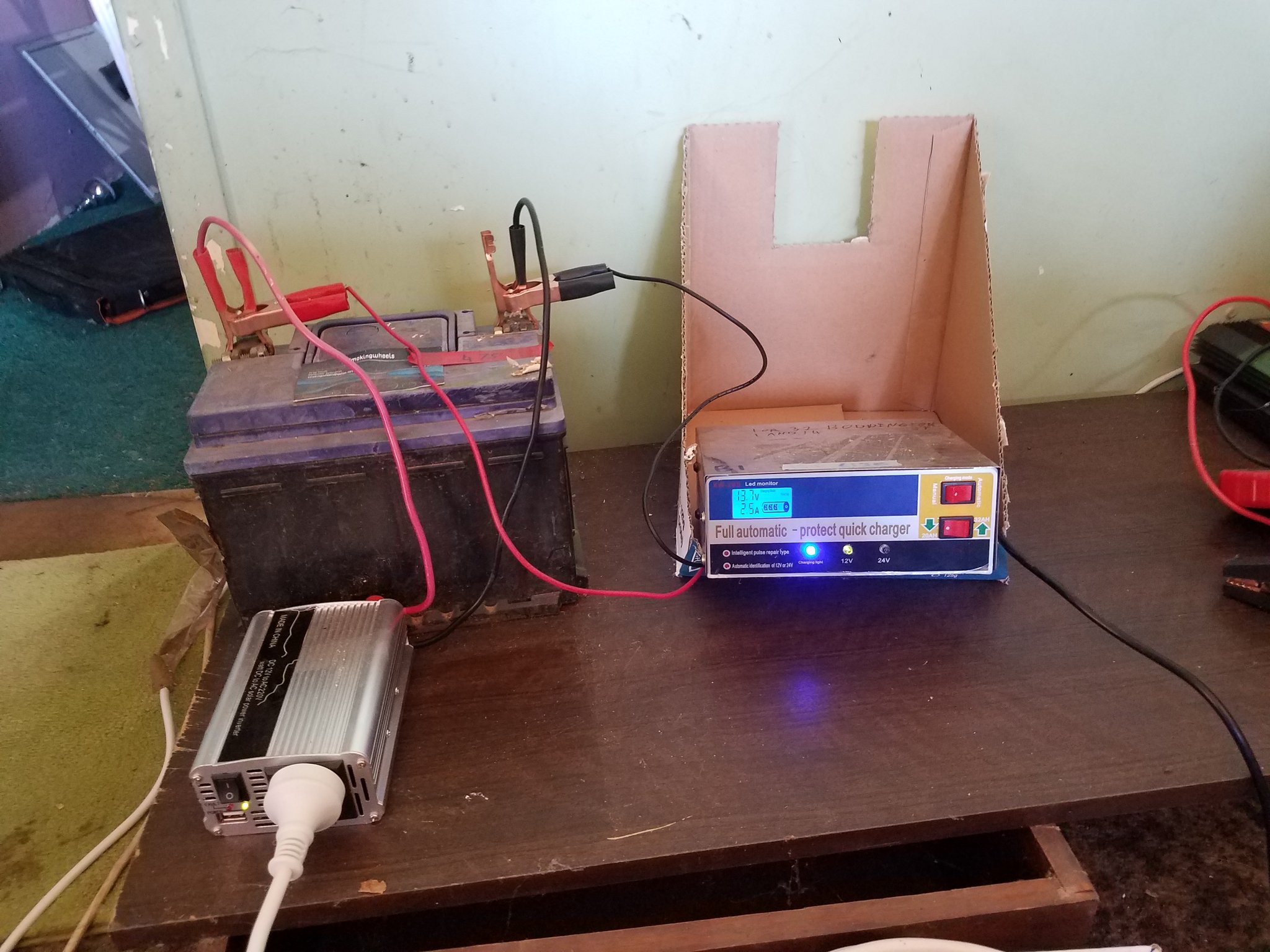

Im using an 12 Volt inverter a $5 car battery and charger.
Did a test today it lasted over 30 mins to approx state of charge 50% of battery.
I like your setup @smokingwheels
What inverter are you using and where could you get a decent battery for $5?
The inverter, was about $35 off ebay.
The Battery, I put a wanted ad on local buy and sell on Facebook for old car batteries.
The charger, is a pulse repair one approx $35 off ebay.

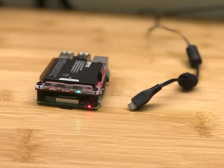

If you want to really do a proper UPS for the PI here are a bunch of articles you might be able to replicate or purchase if the hardware is still available:
https://www.kickstarter.com/projects/1842571016/piups-uninterruptible-power-supply-for-raspberry-p
https://www.kickstarter.com/projects/tjohn327/power-pi-a-smart-ups-for-the-raspberry-pi
Probably the best one http://raspi-ups.appspot.com/en/index.jsp
and here's a power bank sold for this https://www.adafruit.com/product/1566
