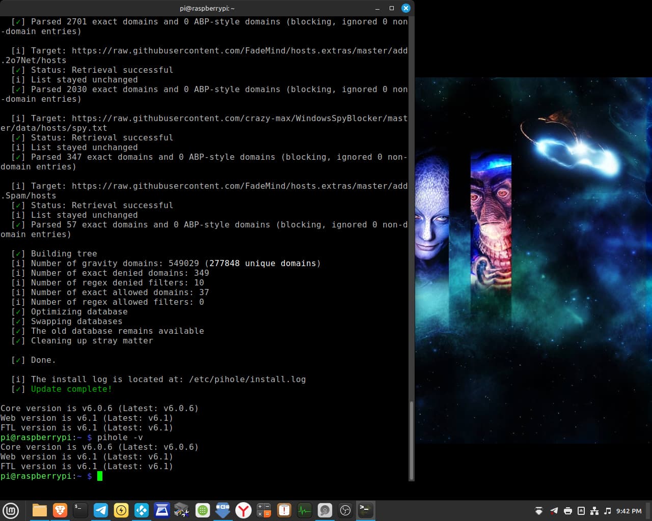

Hmmm...
This won't work either, because v6 installation was started, but failed midway... Now there are a mix of Pi-hole v6 (core and web) with Pi-hole v5 (FTL).
I think the best solution would be to start over, but we can try one last thing.
@BobbyB, you can try to repair your current installation.
If it works the process will finish the v6 installation and your settings will be migrated. No need to manually copy the configuration, but as a suggestion, I think you could backup the /etc/pihole directory and all its files (just in case).
To repair Pi-hole, usually the command is pihole -r, but since you are using an unsupported OS, you will need to run:
sudo PIHOLE_SKIP_OS_CHECK=true pihole -r
If the process finishes without errors, please post the output of pihole -v.
Hello,
the update worked. i can now access the pihole web interface/ admin page. Do i still need to update the raspberry pi buster OS ( 10) to bookworm OS (12)?

Here's my pihole -v after that (and a pihole -r, trying to resolve the /admin Forbidden symptoms)
Pi-hole version is v6.0.6 (Latest: v6.0.6)
web version is v6.1 (Latest: v6.1)
FTL version is v5.25.2 (Latest: v6.1)
Turns out the only way was to keep going
