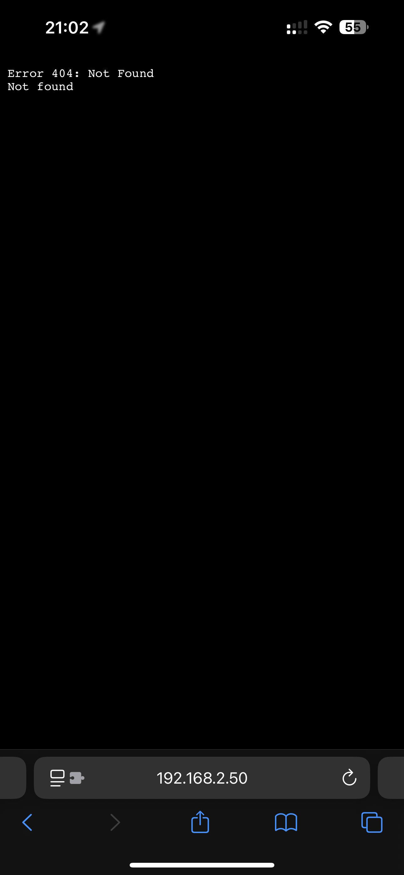

Unfortunately the original problem still exists. I get 404 when opening the admin interface in browser.

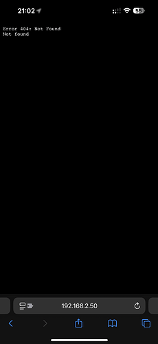

Are you still unable to access the web interface via http (without the s) - http://192.168.2.50:8081/admin?
Yes, indeed. Still 404.
This doesn't seem the error message sent by the Pi-hole web server.
Apparently a different web server is answering (maybe nginx)?
Did you include the port? Do you see the request in webserver.log?
Yes it is the answer of the Pi-hole Webserver. I did use the correct port and yes, I do see the requests in the Webserver.log (as can be seen in my previous posts).
Also, in the logs provided you can see that port 8081 is served by the pihole process.
It tries to serve the admin dir, cannot find it, tries to serve the 404 error page, but cannot find it either - and therefore seemingly shows this plain and simple response.

I don’t know what client tried to access that, I will check that later.
But in the browser I explicitly try to GET http://192.168.2.50:8081/admin/
This should be the correct URL, isn’t it?

I'm not sure what is causing your issue. Do you see the same if you try to access from a different device?
Yes, any device shows this behaviour, phone, table computer…
