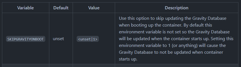

Per the Readme.........
https://github.com/pi-hole/docker-pi-hole/tree/development-v6#advanced-variables

As it is now, skipping gravity on boot via the readme instructions will prevent the startup delay you are seeing.
