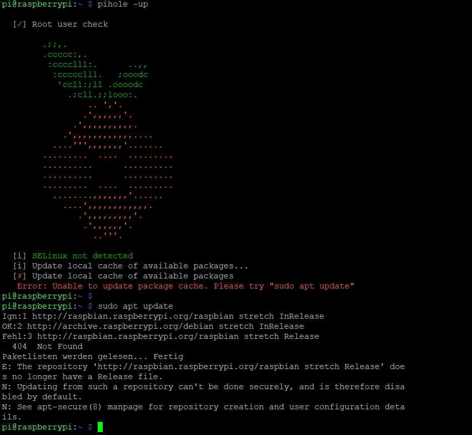

Wollte Pihole updaten weil die Version 5.xx drauf ist, leider funktioniert dies nicht.
Bekomme immer diese Meldung
Kann mir jemand dabei helfen was ich machen muss?

These error messages are from your OS, not from Pi-hole.
You are running a very old OS (Stretch - also known as Debian 9).
This OS was released in 2017 and it can't be updated anymore because it reached its End Of Life a long time ago.
You won't be able to update this system.
Also, the current Pi-hole versions (v6.x) can't be executed on Stretch.
Suggestion:
  • create a Pi-hole backup (teleporter) using the Web Interface or the command line (pihole -a -t);
  • save the backup on a different machine;
  • install a newer OS. The current version is: Raspberry Pi OS 13 (Trixie);
  • install Pi-hole on the new OS (curl -sSL https://install.pi-hole.net | bash);
  • restore the backup using the web interface.
