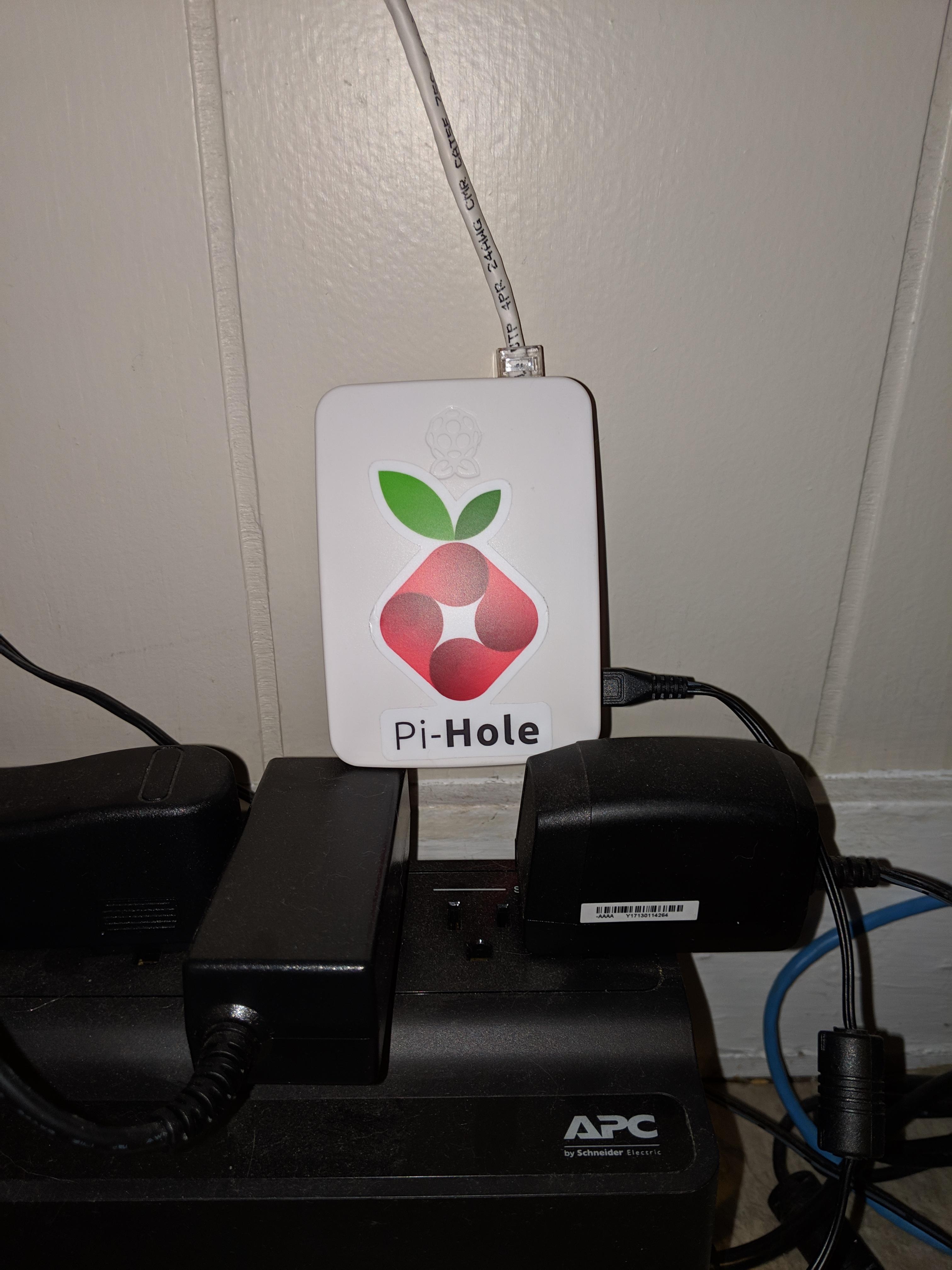

This is the device in question, giving me issues:
