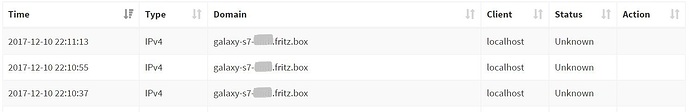

I have fhem and pi-hole installed on a Raspberry Pi 3.
After update pi-hole to v3.2, I expected that the querys which made by fhem's lan-ping-module are shown as OK in the query log (like it was before the update).

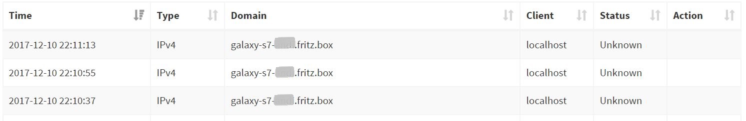

Queries which made by the lan-ping-module in fhem are shown with status unknown in query log.

What is going wrong?
If I run nslookup galaxy-s7-andi.▓▓▓▓▓.box, I get the right response and the query has status OK in the log.

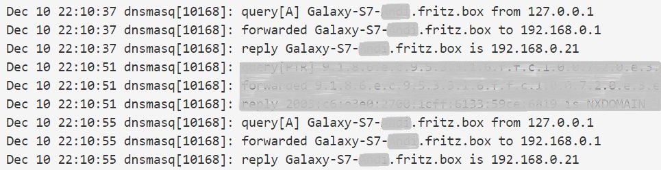

While the Query Log shows unknown status, I see while tailing pihole.log that the query has been forwarded to the router (192.168.0.1):

Same problem after update to V 3.2. (192.168.1.1 is router)
Restarting FTL didn't change anything. No /etc/pihole/lan.list file.

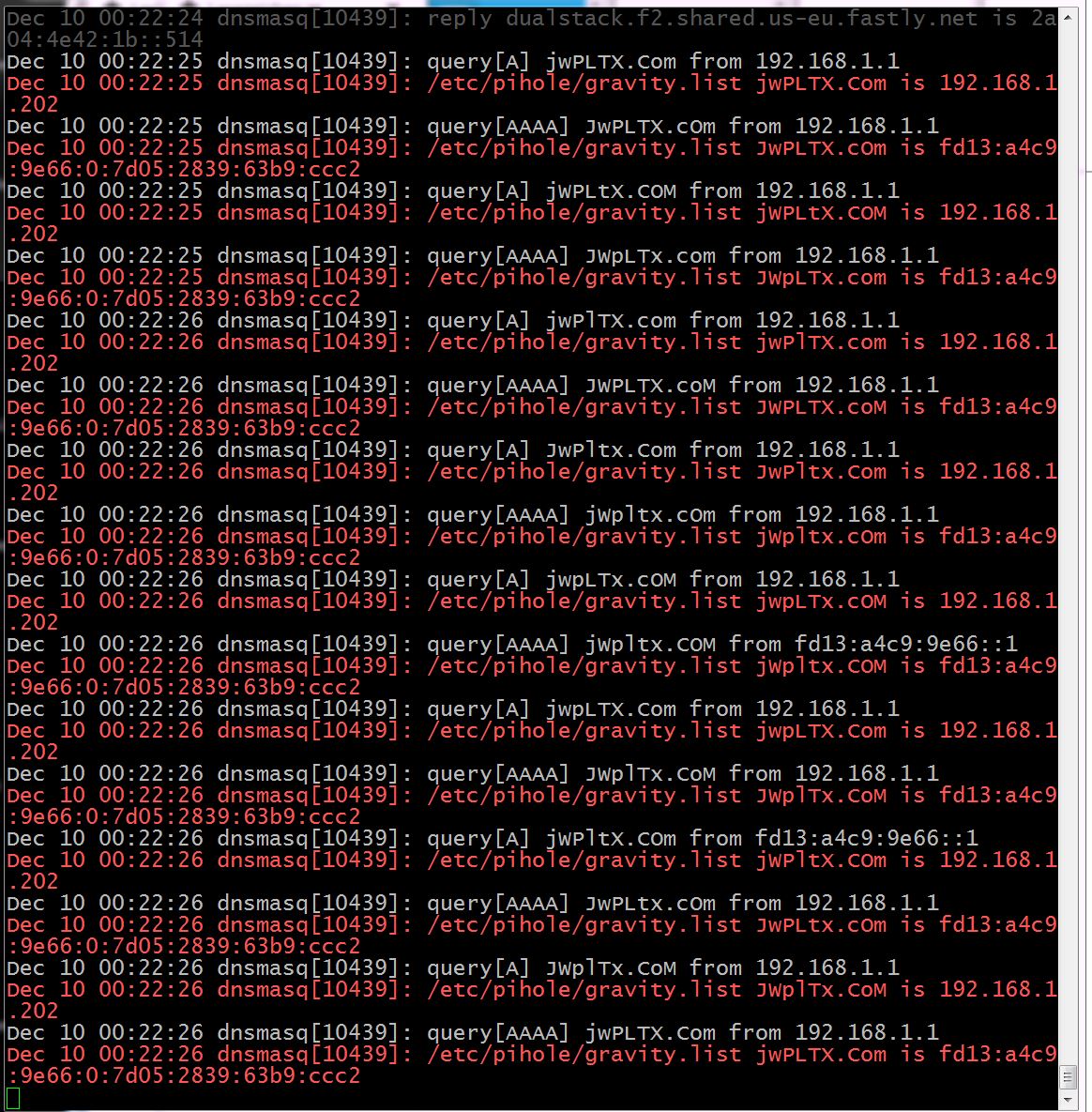

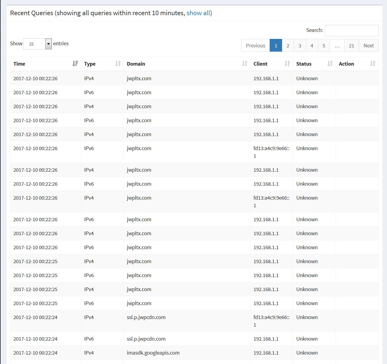

Okay, it seems to be a problem with mixed cases domains (like GooGle.coM), I'm working on this right now.
I opened an issue report to be able to keep track on GitHub
https://github.com/pi-hole/FTL/issues/170
Bug fix incoming
https://github.com/pi-hole/FTL/pull/171
