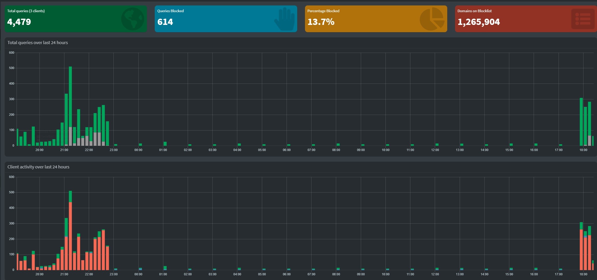

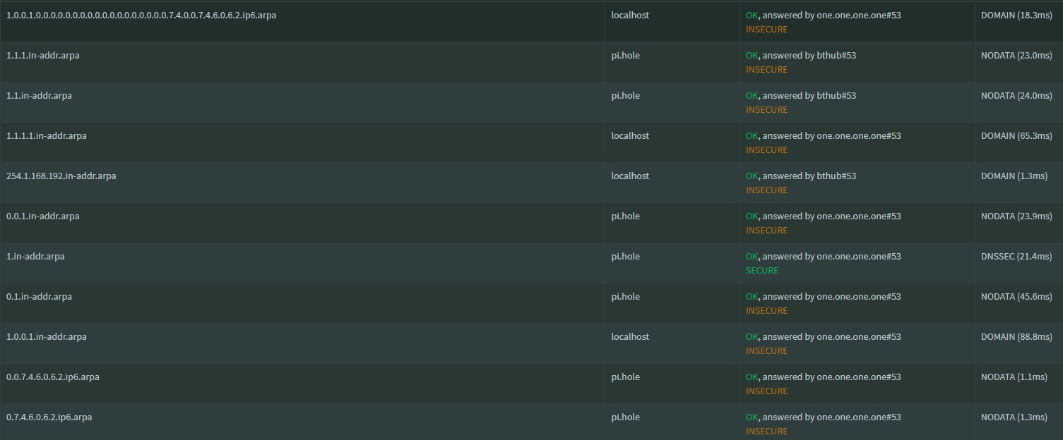

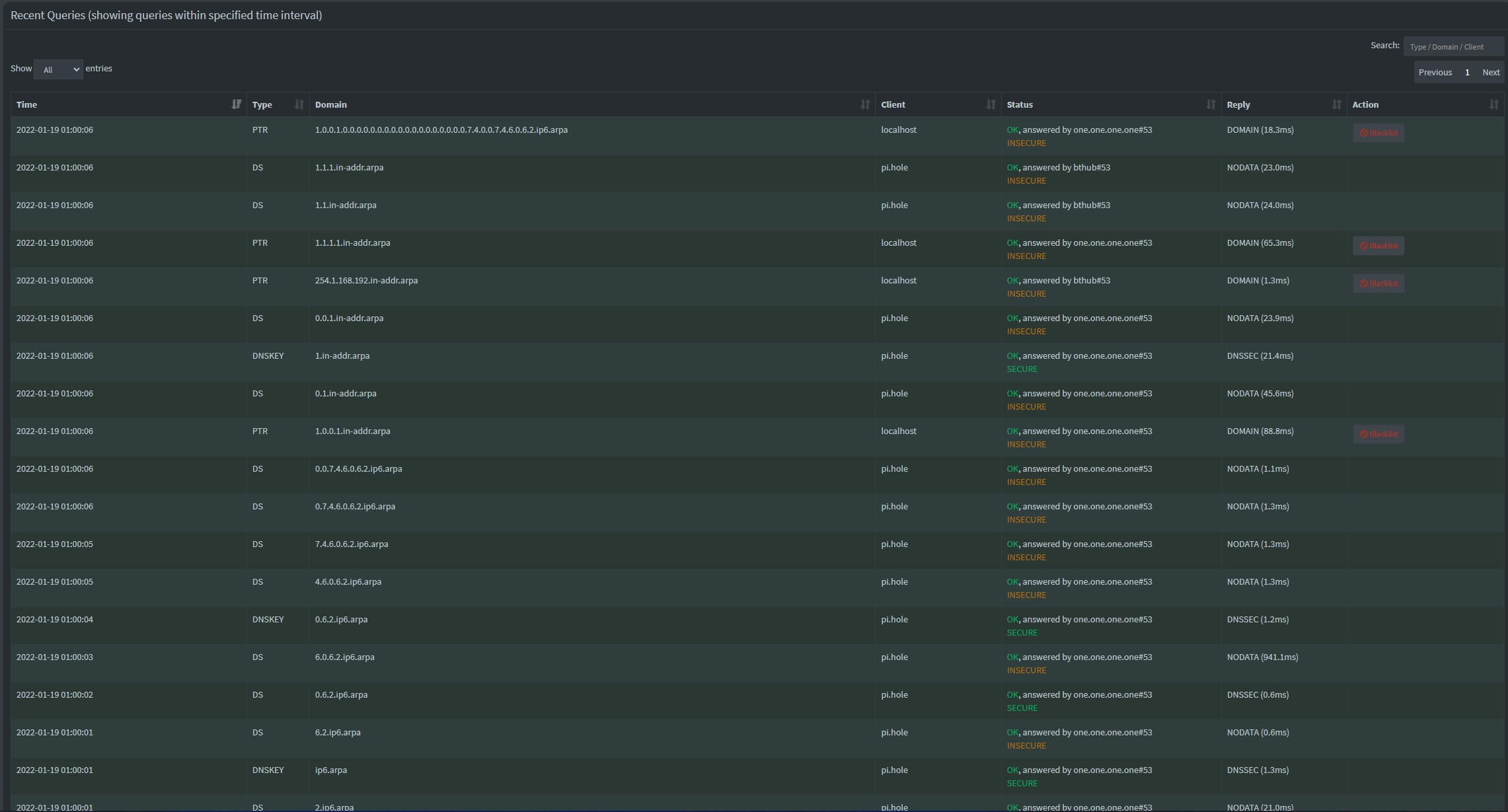

Does anyone know what these are pictures included. It seems to be constant, I have 1 device using pihole which is powered off from 23:00 - 18:00 although looking at the traffic these are still being requested by pi.hole and localhost
1.0.0.1.0.0.0.0.0.0.0.0.0.0.0.0.0.0.0.0.0.0.7.4.0.0.7.4.6.0.6.2.ip6.arpa
1.1.1.in-addr.arpa
1.1.in-addr.arpa
1.1.1.1.in-addr.arpa
254.1.168.192.in-addr.arpa
0.0.1.in-addr.arpa
1.in-addr.arpa)
0.1.in-addr.arpa
1.0.0.1.in-addr.arpat
0.0.7.4.6.0.6.2.ip6.arpas
4.6.0.6.2.ip6.arpa

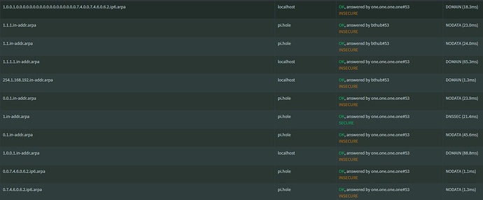

These are reverse IP queries from Pi-hole (PTR requests). As you can see, they are happening on the hour.
This is Pi-hole determining the names of your DNS servers and the clients on your network.
A PTR request shows the IP in reverse order, so 254.1.168.192.in-addr.arpa is asking the question "what is the name of the client located at IP 192.168.1.254".
1.1.1.1.in-addr.arpa is looking for the name of the Cloudflare DNS server.
The related DS and DNSKEY transactions are due to DNSSEC.
This is normal activity for Pi-hole.
