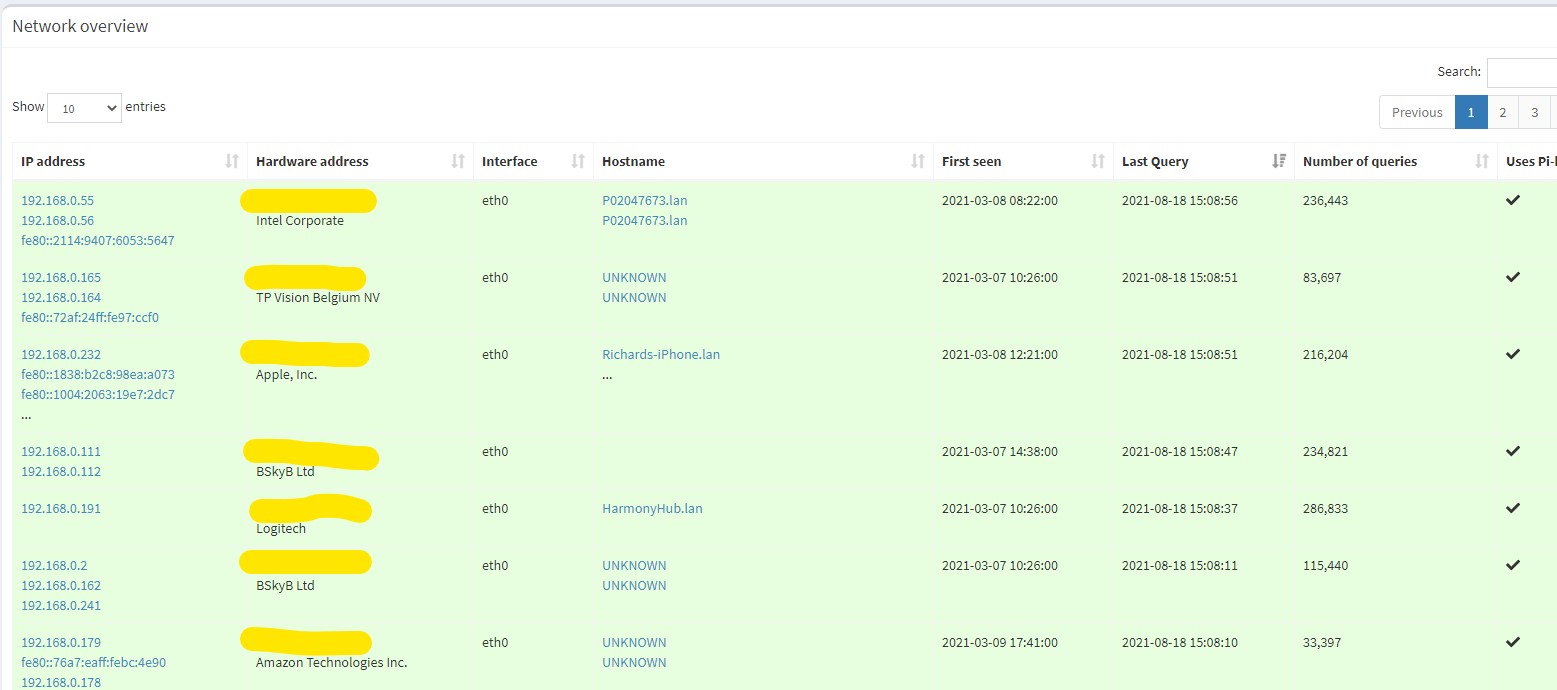

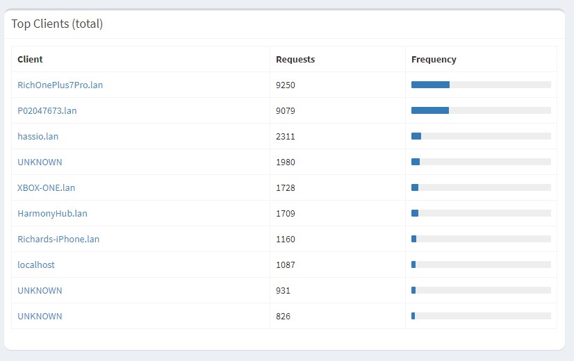

I see some devices showing as UNKNOWN in the dashboard.
In the network table I see some devices with multiple IP assignments.
Im also seeing IPV6 addresses, when I have this disabled?
https://tricorder.pi-hole.net/DyNXV1Rm/
Have you recently made changes to your DHCP server? Some of the IP's are adjacent, which can indicate that the lease was renewed and the DHCP server assigned the next IP in line. When Pi-hole is the DHCP server, IP's tend to be scattered across the allowable IP range, since the deterministic DHCP server in dnsmasq will hash the MAC ID of the client to assign an IP (IPs are typically not assigned sequentially to clients).
These aren't multiple current assignments, this is the history of IP's assigned to that specific MAC ID (or DUID).

In terms of my network table, is there a real problem with the screenshot I posted above, or is this normal / OK behaviour?
And IPV6? Which I thought was disabled

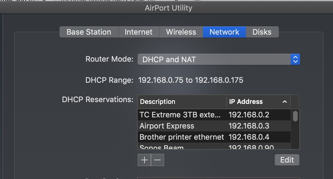

Reserved/static IP's in a router are reservations. You are telling the router to save a specific IP to be assigned only to the specified client. Using this method provides some feedback from the router - it won't let you assign the same IP to multiple devices.
For my network (router and six Pi-holes) I prefer to do the DHCP work at the router. I reserve IP's for all my regular network clients, and then put the same entries into the /etc/hosts file on each Pi. Then, regardless of which Pi-hole a client chooses, the same name will show up in the Pi-holes.

Nothing I would worry about.
You are seeing link-local addresses. Also normal.

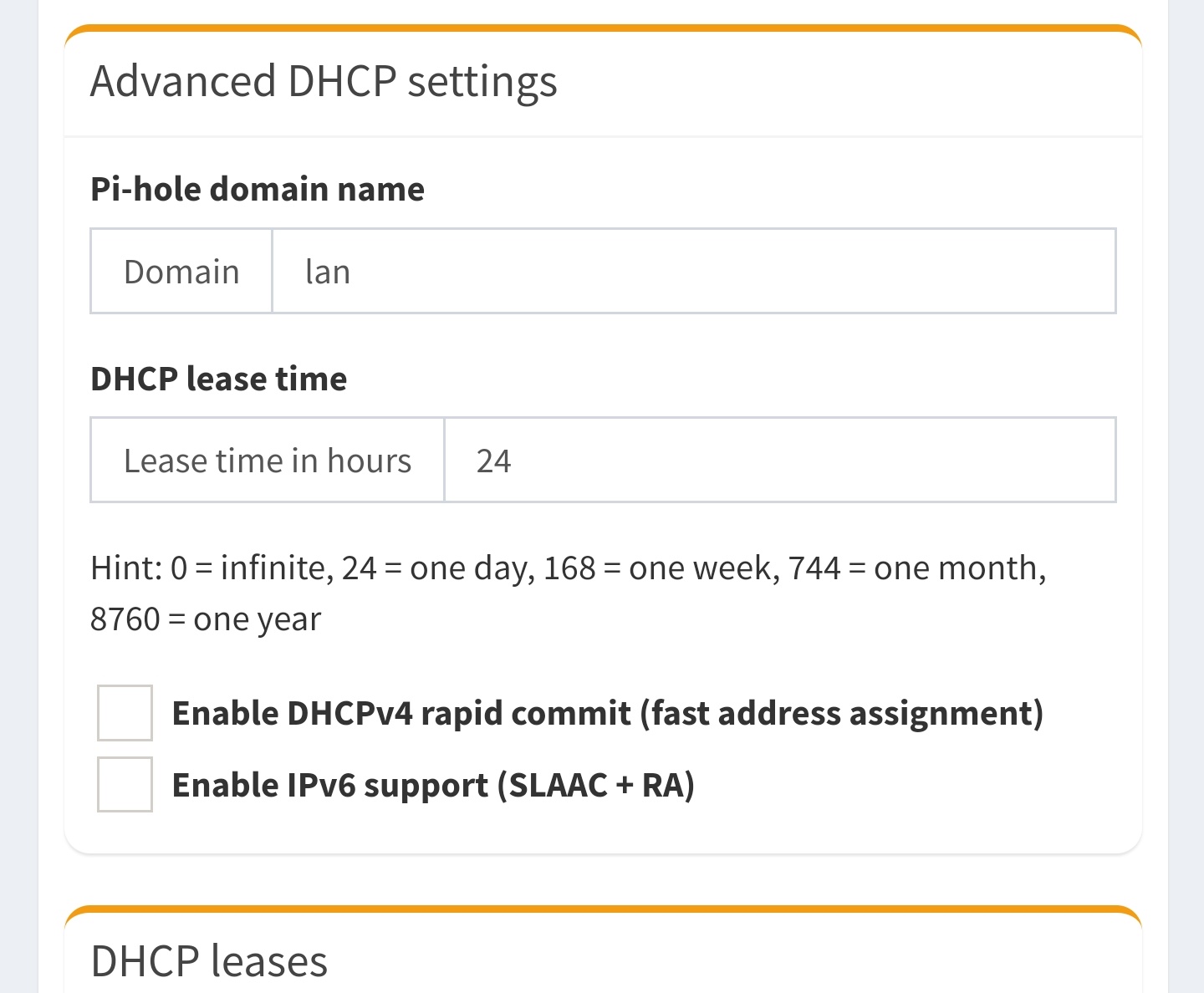

ah ok, i thought pihole added the .lan as per the settings:
