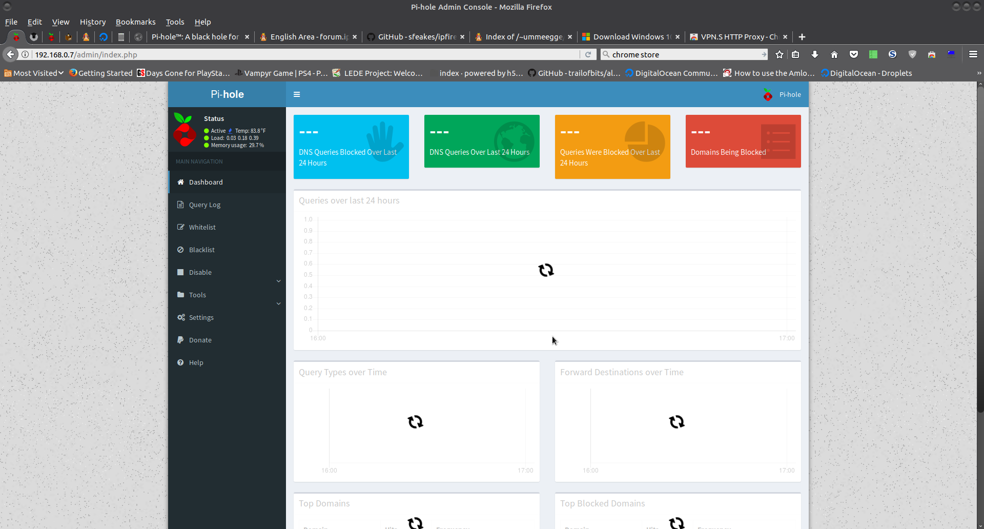

Iv'e just recently been unable to see stats on the dashboard.
I have tried pihole -r to repair and reconfigure, and also the original install command without any difference in interface performance.

Can you give a screenshot of what you see on the web interface? FTL appears to be running.
The arrows just keep going around.

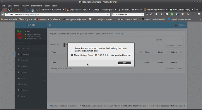

And also the query log gives 'unknown error'
