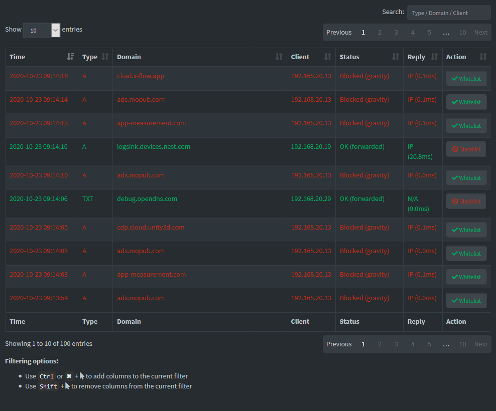

I've got a USG that is using my raspberryPi with Pihole client as it's DNS. Everything is working great but the only issue is the the piHole is seeing/logging all requests as USG and not the actual client that made the DNS request.
Is there any way to get the piHole to see the clients and not just the USG?

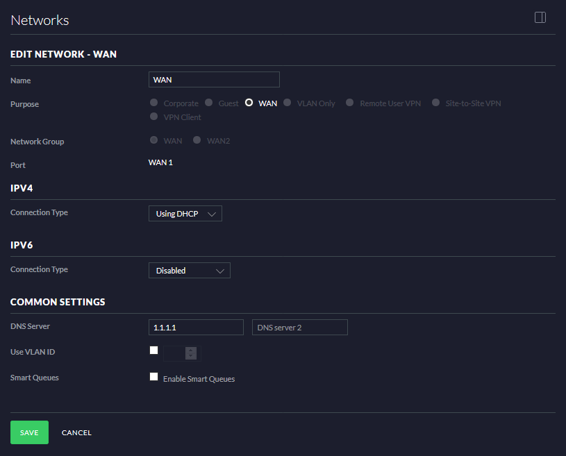

USG WAN - working as my upstream DNS

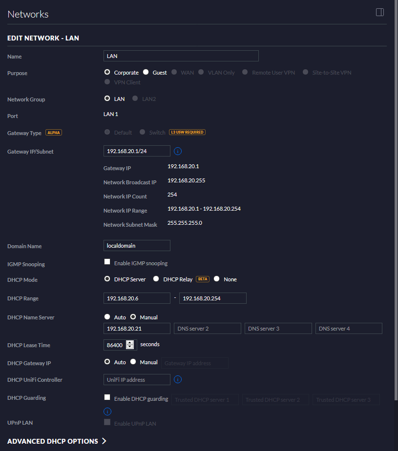

LAN - pointing to the piHole as DNS

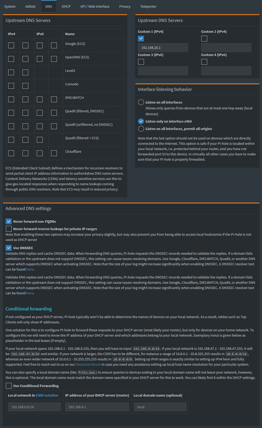

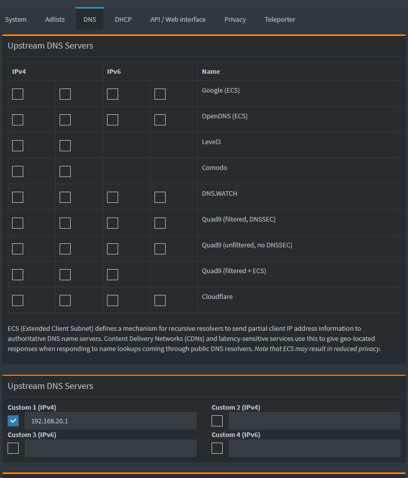

From your screenshot, it would seem that you have configured Pi-hole to use your router at 192.168.20.1 as upstream, so in theory, your router should provide the answer for local names.
For this to work, verify that Never forward reverse lookups for private IP ranges is unticked under Advanced DNS settings on Settings | DNS.

Well it looks like enabling conditional forwarding solved my issue, the Pi-Hole is getting full on client names :slight_smile:
I am just wondering if the rest the setup is correct, because now I am pointing my WAN DNS to 1.1.1.1 and using LAN to point to Pi-Hole for DNS. And then the Pi-Hole is using the WAN USG as Upstream DNS Server.

@Bucking_Horn ok I tried the method with Conditional forwarding disabled and sorry you were right I did have Never forward reverse lookups for private IP ranges ticked
So my USG WAN is pointing to 1.1.1.1 for it's upstream DNS, my LAN networks are pointing to Pi-Hole and the Pi-Hole is using the USG router as it's upstream DNS.

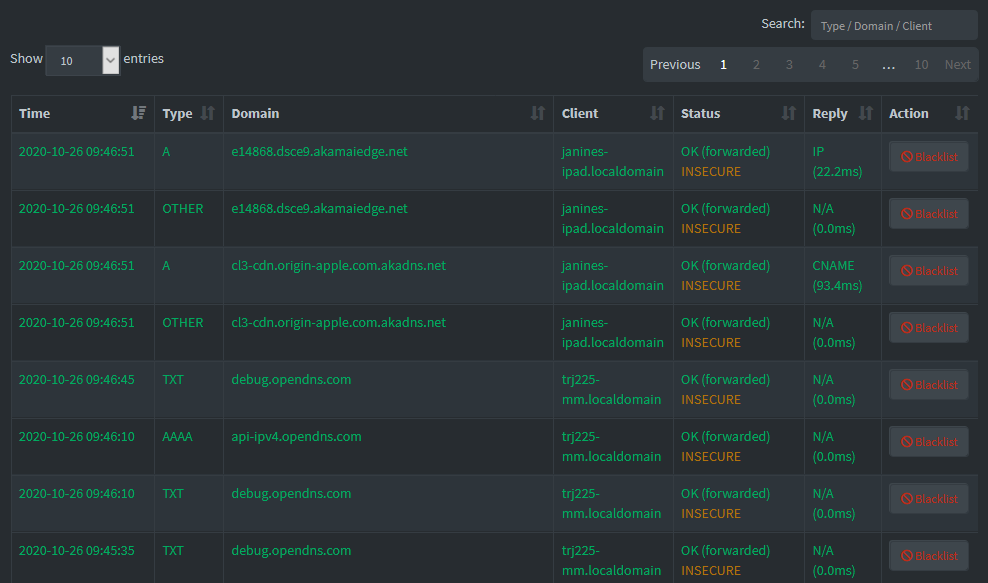

The hostname doe appear to be working now but I get an odd insure message now for every connection:
What's happening here?
