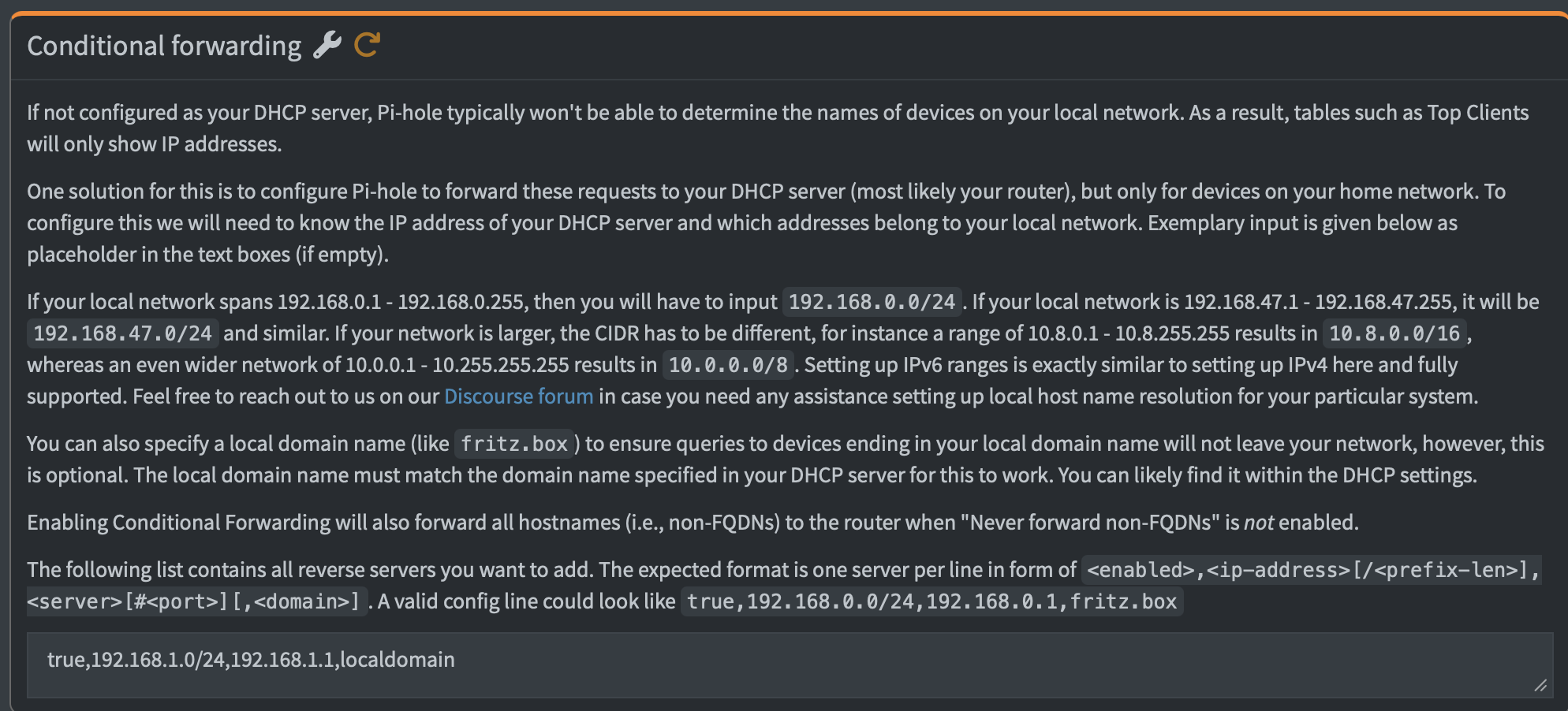

In Pi-hole go to Settings > DNS > scroll down to Advanced DNS settings and enable Conditional Forwarding. Set your local domain name and the router IP (192.168.1.1). This lets Pi-hole look up hostnames from the Unifi DHCP leases and you get proper client names.
The conditional forwarding step is what most people miss - without it Pi-hole can see the individual IPs but can't resolve the hostnames.

[I think that’s what I have configured, but I will attach screenshots.]
[true,192.168.1.0/24,192.168.1.1,localdomain]
