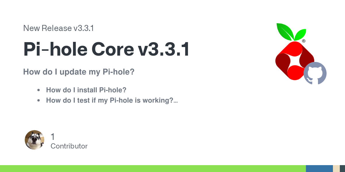

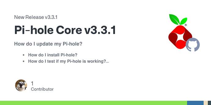

So... I see there is a new version available : To update or to wait ?!
3.3.1 is a small bug fix release.
