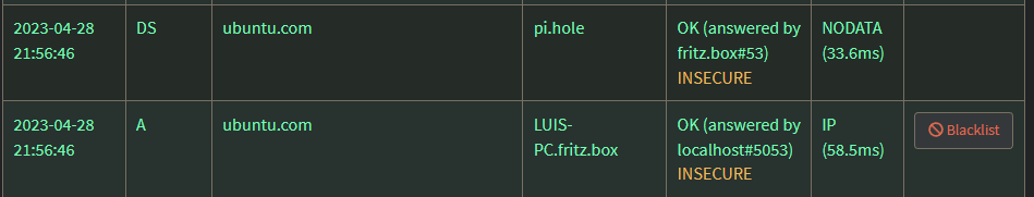

When I look at the query log in the web UI I can see that two record types are being resolved for, say, ubuntu.com in the UNCACHED state: A and DS
The DS record is forwarded to my router (not sure why??) on port 53 and returns NODATA in 14.2ms
The A record is forwarded to localhost#5053 and returns IP in 28.8ms
In the cached scenario I see only the A record returned and it's from the cache.

Apr 28 21:26:04 dnsmasq[1181236]: dnssec-query[DS] ubuntu.com to 127.0.0.1#5053
Apr 28 21:56:46 dnsmasq[1195123]: dnssec-query[DS] ubuntu.com to 127.0.0.1#5053
and the web UI shows:

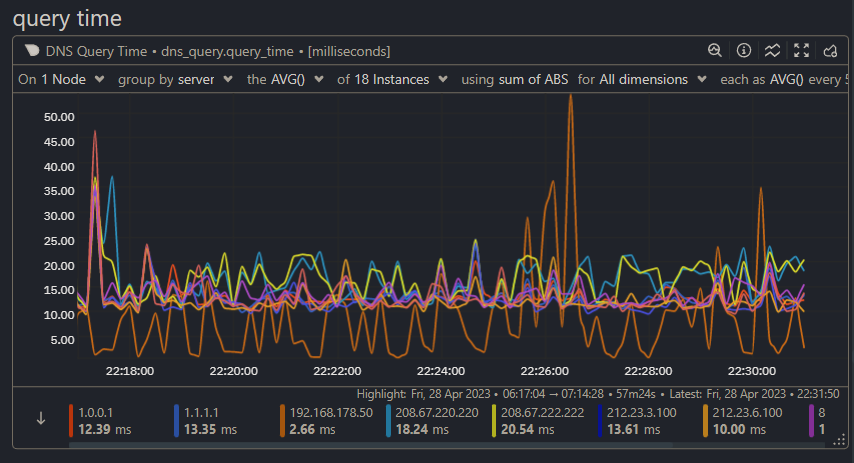

You are correct about Netdata and that's actually how this got started :slight_smile:
I have it setup to monitor DNS performance against a number of hosts, and permutations of IPv4 vs. IPv6:
Another good lesson from this is that I need to choose my target domain names more carefully so that if/when I see spikes in DNS latency I can know whether it's due to normal TTL expiry (which I don't care about) or due to some other sort of issue (which I do care about).
I have some questions for another thread but will hopefully be better informed :smiley:
I am not familiar with that specific netdata collector you are showing, but you want to be careful about the number and frequency of DNS requests it is sending to Pi-hole, in order to avoid triggering Pi-hole's rate-limiting and/or saturating its concurrent connection pool at times. You also want to keep an eye on log and database sizes.
Thank you for providing the logs as well as the UI for that DS lookup.
As the log shows the request to be forwarded to your local cloudflared at 127.0.0.1#5053, this seems to be an UI glitch.
I can confirm that this is also happening with my Pi-hole - thank you for the heads-up.
