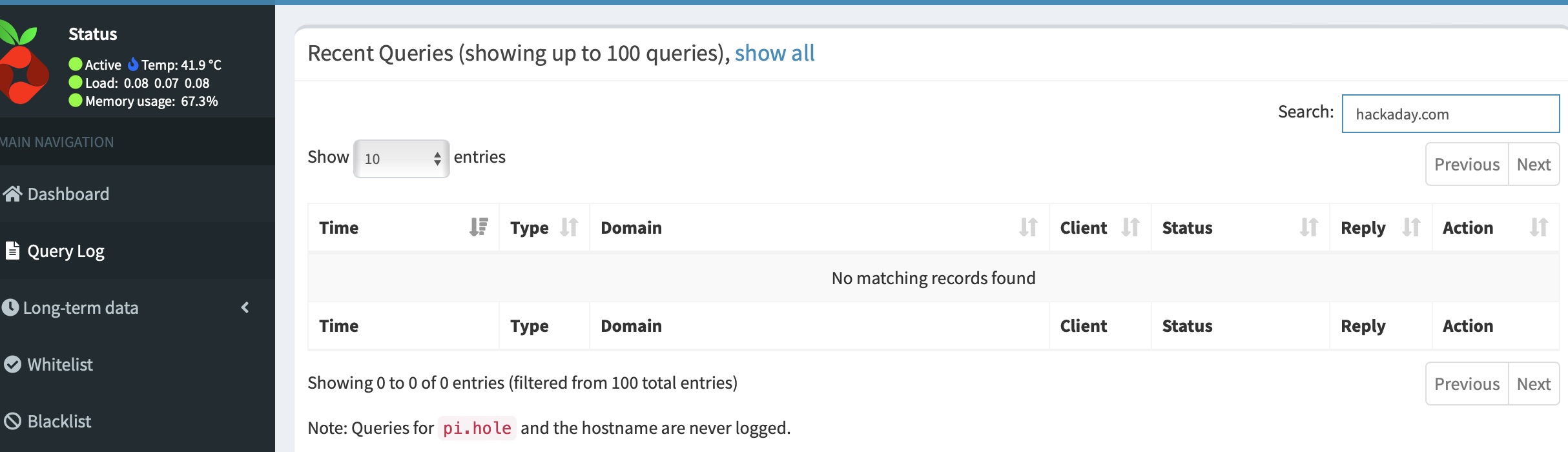

I seem to get some of the reporting through however not all. Given that there is an upstream dns resolver, is pihole simply recording the fact that clients are resolving to 1.1.1.1 or does it report on all occasions the actual dns query. The reason I ask is that I query the long term log and I cannot see some entries as an example a Whois enquiry I made. Do I need to do unbound for this BOOMEL

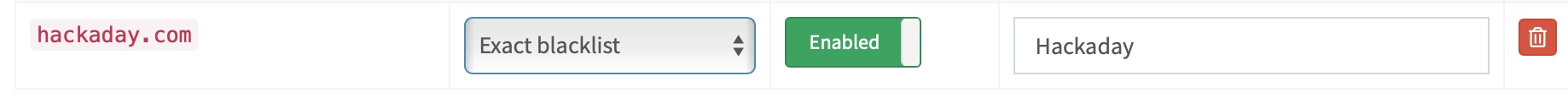

Ok I have set it to be 192.168.1.6 only but still cannot see in query lo. I have blocked hackaday.com as an example and it does not show in log as either blocked or in the reporting
