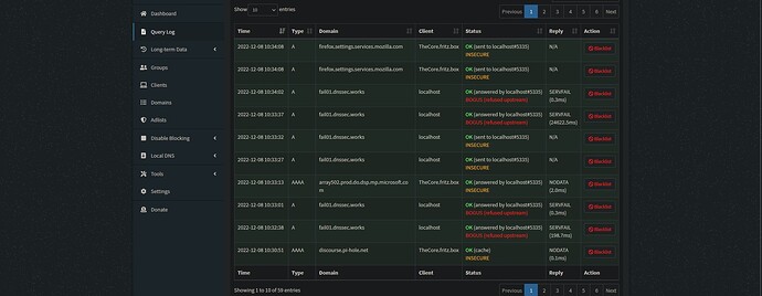

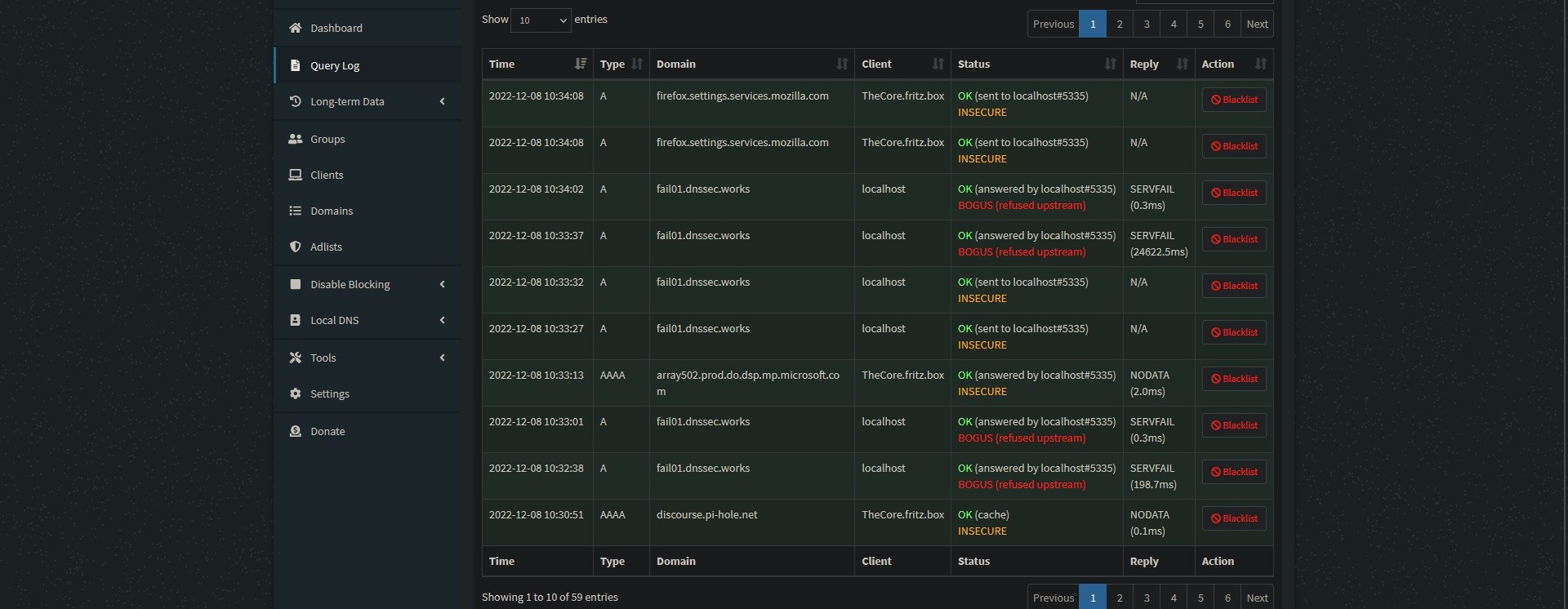

Weiterhin wollte ich wie im Pihole unter Settings->DNS-> DNSSEC mit dieser Seite DNSSEC testen aber die ist offline https://dnssec.vs.uni-due.de/
Hier nochmal ein Bild: Wenn ich Timeout habe steht bei Pihole N/A

512     -- result # 2
running the tests for the domain good-A.test.dnssec-tools.org produces identical results.
looking at the results from DNSSEC Analyzer (verisignlabs.com):
not sure here, my interpretation is that there is something wrong with the nameservers for the domains.
my work around for these kind of (unbound) problems:
/etc/dnsmasq.d/17-BypassUnbound.conf
server=/discourse.pi-hole.net/127.10.10.5#5555
server=/discourse.b-cdn.net/127.10.10.5#5555
server=/docs.pi-hole.net/127.10.10.5#5555
server=/piholediscourse.b-cdn.net/127.10.10.5#5555
server=/wp-cdn.pi-hole.net/127.10.10.5#5555
/etc/dnsmasq.d/18-serversfile.conf
servers-file=/etc/dnsmasq.d/17-BypassUnbound.conf
As you know, this configuration requires only a SIGHUP to reread the specific server configuration (dnsmasq man --servers-file=<file> )
pid=$(ps -e | grep 'pihole-FTL' | awk '{print $1}')
sudo /bin/kill -1 $pid
The entries in the file /etc/dnsmasq.d/17-BypassUnbound.conf are required (for me only), due to my unbound RPZ configuration and the ever changing address of the domains (hosted by a cloud provider?), just examples for the readers.
However ...
To overcome (unbound?) problems with the domains we have been using in this topic, one could use entries like:
server=/fail01.dnssec.works/8.8.8.8
server=/good-A.test.dnssec-tools.org/8.8.8.8
It looks like (dig @8.8.8.8 +trace fail01.dnssec.works) has the missing information cached, thus using their cached information, the domain query is producing the expected reply.
If you put the text inside an inline code block like this @127.10.10.5 - p 5555, the @ doesn't trigger a mention.
Another example: @jpgpi250
Don't do that.
While this may allow the dig commands to produce the expected results, it would also completely defeat the purpose of verifying your unbound installation - you are running them via Google's DNS servers instead.
We've only recently switched our documentation to use the dnssec.works domain for verification, as the previous ones seemingly went out of business.
Given OP's observation, there may be a better alternative, but until we found that, I'd stick with testing unbound instead of Google. :wink:
Bitte nicht nachmachen.
Dies kann zwar dazu führen, dass die dig-Befehle die erwarteten Ergebnisse liefern, aber es würde auch den Zweck der Überprüfung Deiner unbound-Installation völlig zuwider laufen - Du testest stattdessen Googles DNS-Server.
Wir haben unsere Dokumentation erst vor kurzem auf die Verwendung der Domäne dnssec.works zur Überprüfung umgestellt, da die vorherigen Server anscheinend ihren Betrieb eingestellt haben.
In Anbetracht der Beobachtung des OP könnte es wohl eine bessere Alternative geben, aber bis wir diese gefunden haben, würde ich erst einmal dabei bleiben, unbound anstelle von Google zu überprüfen. :wink:
The entire point of me using this dnsmasq feature is to bypass my local unbound. I'm NOT saying I would use / recommend this to verify DNSSEC is working, I'm using this to get to domains that aren't reachable, using unbound. I also don't use @8.8.8.8 (google) to bypass unbound, I'm using a locally installed knot resolver (also DNSSEC capable) to get an answer for the query (see the first section of examples, using @127.10.10.5#5555
I just used @8.8.8.8 as an example to explain that using an alternative upstream resolver is possible, this for users that don't have a second local recursive resolver installed.
As far as I'm aware, both @8.8.8.8, @1.1.1.1, @9.9.9.9, ... are using DNSSEC, so the user that has DNSSEC enabled, using pihole, is warned about DNSSEC errors, even if NOT using unboud as upstream.
Again, the proposed solution (that I have been using for a few months now) needs to be implemented only, if the domain query is, and remains, unresolvable using unbound, e.g. work around.
trying this, now, 6 @ code blocks in this reply, thanks for the hint, learned something here, again...
I have created an Issue on Github Unbound:
https://github.com/NLnetLabs/unbound/issues/803
