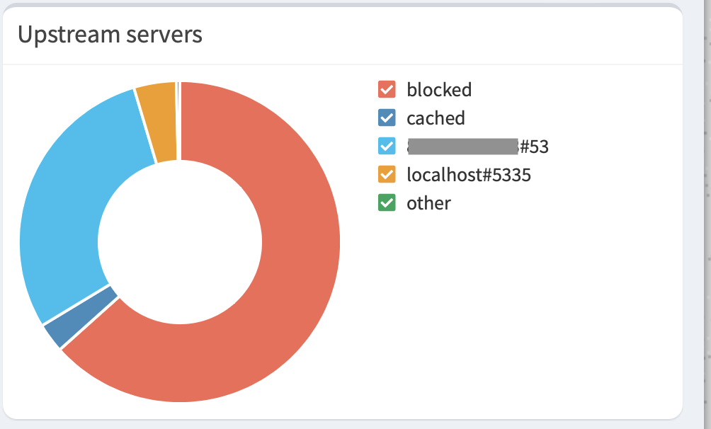

Hi, see screenshot. This is after a couple of hours using both Unbound on the Raspberry and on the VPS. Looks like shared between the both with majority to the VPS. Might be OK to run both as redudancy?
If that's what you want, no harm
