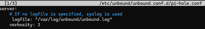

hi folks
i need help with unbound, I'm getting SERVERFAIL with all the requests that go through it, I'm did what all the posts that I found says but first I don't understand a bunch about network (Some might say I don't understand anything) second the error that appears in most cases seems different from mine.
ill leave some of the common things that people ask for in the post hoping it might help

I got it to work (a year or so ago), but yesterday I noticed that it wasn't working properly, so I formatted the whole thing and started from scratch

  • sudo journalctl --no-pager -u unbound
Jul 03 13:12:49 orangepizero2 systemd[1]: Starting unbound.service - Unbound DNS server...
Jul 03 13:12:50 orangepizero2 unbound-helper[10586]: Updating /var/lib/unbound/root.key from /usr/share/dns/root.key
Jul 03 13:12:50 orangepizero2 (unbound)[10592]: unbound.service: Referenced but unset environment variable evaluates to an empty string: DAEMON_OPTS
Jul 03 13:12:50 orangepizero2 unbound[10592]: [1751548370] unbound[10592:0] error: can't bind socket: Address already in use for ::1 port 53
Jul 03 13:12:50 orangepizero2 unbound[10592]: [1751548370] unbound[10592:0] fatal error: could not open ports
Jul 03 13:12:50 orangepizero2 systemd[1]: unbound.service: Main process exited, code=exited, status=1/FAILURE
Jul 03 13:12:50 orangepizero2 systemd[1]: unbound.service: Failed with result 'exit-code'.
Jul 03 13:12:50 orangepizero2 systemd[1]: Failed to start unbound.service - Unbound DNS server.
Jul 03 13:12:50 orangepizero2 systemd[1]: unbound.service: Scheduled restart job, restart counter is at 1.
Jul 03 13:12:50 orangepizero2 systemd[1]: Starting unbound.service - Unbound DNS server...
Jul 03 13:12:50 orangepizero2 (unbound)[10605]: unbound.service: Referenced but unset environment variable evaluates to an empty string: DAEMON_OPTS
Jul 03 13:12:50 orangepizero2 unbound[10605]: [1751548370] unbound[10605:0] error: can't bind socket: Address already in use for ::1 port 53
Jul 03 13:12:50 orangepizero2 unbound[10605]: [1751548370] unbound[10605:0] fatal error: could not open ports
Jul 03 13:12:50 orangepizero2 systemd[1]: unbound.service: Scheduled restart job, restart counter is at 2.
Jul 03 13:12:51 orangepizero2 systemd[1]: Starting unbound.service - Unbound DNS server...
Jul 03 13:12:51 orangepizero2 (unbound)[10620]: unbound.service: Referenced but unset environment variable evaluates to an empty string: DAEMON_OPTS
Jul 03 13:12:51 orangepizero2 unbound[10620]: [1751548371] unbound[10620:0] error: can't bind socket: Address already in use for ::1 port 53
Jul 03 13:12:51 orangepizero2 unbound[10620]: [1751548371] unbound[10620:0] fatal error: could not open ports
Jul 03 13:12:51 orangepizero2 systemd[1]: unbound.service: Main process exited, code=exited, status=1/FAILURE
Jul 03 13:12:52 orangepizero2 systemd[1]: unbound.service: Failed with result 'exit-code'.
Jul 03 13:12:52 orangepizero2 systemd[1]: Failed to start unbound.service - Unbound DNS server.
Jul 03 13:12:52 orangepizero2 systemd[1]: unbound.service: Scheduled restart job, restart counter is at 3.
Jul 03 13:12:52 orangepizero2 systemd[1]: Starting unbound.service - Unbound DNS server...
Jul 03 13:12:52 orangepizero2 (unbound)[10680]: unbound.service: Referenced but unset environment variable evaluates to an empty string: DAEMON_OPTS
Jul 03 13:12:52 orangepizero2 unbound[10680]: [1751548372] unbound[10680:0] error: can't bind socket: Address already in use for ::1 port 53
Jul 03 13:12:52 orangepizero2 unbound[10680]: [1751548372] unbound[10680:0] fatal error: could not open ports
Jul 03 13:12:52 orangepizero2 systemd[1]: unbound.service: Main process exited, code=exited, status=1/FAILURE
Jul 03 13:12:52 orangepizero2 systemd[1]: unbound.service: Scheduled restart job, restart counter is at 4.
Jul 03 13:12:52 orangepizero2 (unbound)[10699]: unbound.service: Referenced but unset environment variable evaluates to an empty string: DAEMON_OPTS
Jul 03 13:12:52 orangepizero2 unbound[10699]: [1751548372] unbound[10699:0] error: can't bind socket: Address already in use for ::1 port 53
Jul 03 13:12:52 orangepizero2 unbound[10699]: [1751548372] unbound[10699:0] fatal error: could not open ports
Jul 03 13:12:53 orangepizero2 systemd[1]: unbound.service: Scheduled restart job, restart counter is at 5.
Jul 03 13:12:53 orangepizero2 systemd[1]: unbound.service: Start request repeated too quickly.
Jul 03 13:12:53 orangepizero2 systemd[1]: unbound.service: Failed with result 'exit-code'.
Jul 03 13:12:53 orangepizero2 systemd[1]: Failed to start unbound.service - Unbound DNS server.
Jul 03 13:14:46 orangepizero2 systemd[1]: Starting unbound.service - Unbound DNS server...
Jul 03 13:14:46 orangepizero2 (unbound)[10800]: unbound.service: Referenced but unset environment variable evaluates to an empty string: DAEMON_OPTS
Jul 03 13:14:46 orangepizero2 unbound[10800]: [10800:0] warning: subnetcache: prefetch is set but not working for data originating from the subnet module cache.
Jul 03 13:14:46 orangepizero2 unbound[10800]: [10800:0] info: start of service (unbound 1.19.2).
Jul 03 13:14:46 orangepizero2 systemd[1]: Started unbound.service - Unbound DNS server.
Jul 03 15:38:17 orangepizero2 unbound[10800]: [10800:0] info: service stopped (unbound 1.19.2).
Jul 03 15:38:17 orangepizero2 systemd[1]: Stopping unbound.service - Unbound DNS server...
Jul 03 15:38:17 orangepizero2 systemd[1]: unbound.service: Deactivated successfully.
Jul 03 15:38:17 orangepizero2 systemd[1]: Stopped unbound.service - Unbound DNS server.
Jul 03 15:38:17 orangepizero2 systemd[1]: unbound.service: Consumed 30.949s CPU time, 9.3M memory peak, 0B memory swap peak.
Jul 03 15:38:17 orangepizero2 systemd[1]: Starting unbound.service - Unbound DNS server...
Jul 03 15:38:17 orangepizero2 (unbound)[17718]: unbound.service: Referenced but unset environment variable evaluates to an empty string: DAEMON_OPTS
Jul 03 15:38:17 orangepizero2 unbound[17718]: [17718:0] warning: subnetcache: prefetch is set but not working for data originating from the subnet module cache.
Jul 03 15:38:17 orangepizero2 unbound[17718]: [17718:0] info: start of service (unbound 1.19.2).
Jul 03 15:38:17 orangepizero2 systemd[1]: Started unbound.service - Unbound DNS server.
Jul 03 15:39:48 orangepizero2 unbound[17718]: [17718:0] info: service stopped (unbound 1.19.2).
Jul 03 15:39:48 orangepizero2 systemd[1]: Stopping unbound.service - Unbound DNS server...
Jul 03 15:39:48 orangepizero2 systemd[1]: unbound.service: Deactivated successfully.
Jul 03 15:39:48 orangepizero2 systemd[1]: Stopped unbound.service - Unbound DNS server.
Jul 03 15:39:48 orangepizero2 systemd[1]: Starting unbound.service - Unbound DNS server...
Jul 03 15:39:48 orangepizero2 (unbound)[17753]: unbound.service: Referenced but unset environment variable evaluates to an empty string: DAEMON_OPTS
Jul 03 15:39:48 orangepizero2 unbound[17753]: [17753:0] warning: subnetcache: prefetch is set but not working for data originating from the subnet module cache.
Jul 03 15:39:48 orangepizero2 unbound[17753]: [17753:0] info: start of service (unbound 1.19.2).
Jul 03 15:39:48 orangepizero2 systemd[1]: Started unbound.service - Unbound DNS server.
Jul 03 15:41:19 orangepizero2 unbound[17753]: [17753:0] info: service stopped (unbound 1.19.2).
Jul 03 15:41:19 orangepizero2 systemd[1]: Stopping unbound.service - Unbound DNS server...
Jul 03 15:41:19 orangepizero2 systemd[1]: unbound.service: Deactivated successfully.
Jul 03 15:41:19 orangepizero2 systemd[1]: Stopped unbound.service - Unbound DNS server.
Jul 03 15:41:19 orangepizero2 systemd[1]: Starting unbound.service - Unbound DNS server...
Jul 03 15:41:19 orangepizero2 (unbound)[17782]: unbound.service: Referenced but unset environment variable evaluates to an empty string: DAEMON_OPTS
Jul 03 15:41:19 orangepizero2 unbound[17782]: [1751557279] unbound[17782:0] debug: chdir to /etc/unbound
Jul 03 15:41:19 orangepizero2 unbound[17782]: [1751557279] unbound[17782:0] debug: drop user privileges, run as unbound
Jul 03 15:41:19 orangepizero2 unbound[17782]: [1751557279] unbound[17782:0] debug: switching log to /var/log/unbound/unbound.log
Jul 03 15:41:19 orangepizero2 systemd[1]: Started unbound.service - Unbound DNS server.
Jul 03 15:45:06 orangepizero2 systemd[1]: Stopping unbound.service - Unbound DNS server...
Jul 03 15:45:06 orangepizero2 systemd[1]: unbound.service: Deactivated successfully.
Jul 03 15:45:06 orangepizero2 systemd[1]: Stopped unbound.service - Unbound DNS server.
Jul 03 15:45:06 orangepizero2 systemd[1]: Starting unbound.service - Unbound DNS server...
Jul 03 15:45:06 orangepizero2 (unbound)[17903]: unbound.service: Referenced but unset environment variable evaluates to an empty string: DAEMON_OPTS
Jul 03 15:45:06 orangepizero2 unbound[17903]: [1751557506] unbound[17903:0] debug: chdir to /etc/unbound
Jul 03 15:45:06 orangepizero2 unbound[17903]: [1751557506] unbound[17903:0] debug: drop user privileges, run as unbound
Jul 03 15:45:06 orangepizero2 unbound[17903]: [1751557506] unbound[17903:0] debug: switching log to /var/log/unbound/unbound.log

Its difficult to assist you if you keep moving the target.
Why did you configure the additional logfile directive while it wasnt active previously?
Here we go.
IDK what happened, but here is the thing...
I ran the command on the other post
sudo sed -i 's/verbosity: 0/verbosity: 3/' /etc/unbound/unbound.conf.d/pi-hole.conf
And somehow, even when the config file was set to verbosity 3, unbound wasn't set to verbosity 3.

this is now my new file
 sudo grep -v '#|^$' -R /etc/unbound/unbound.conf*

/etc/unbound/unbound.conf.d/pi-hole.conf:    # If no logfile is specified, syslog is used
/etc/unbound/unbound.conf.d/pi-hole.conf:     logfile: "/var/log/unbound/unbound.log"
/etc/unbound/unbound.conf.d/pi-hole.conf:    verbosity: 3

Its still active:
ok, idk when i did that...
let me try to go back and see what I've done
Restore like it was below and up verbosity.
Thats a proper config if your ISP supports IPv6 upstream.

When I was searching for a solution, someone told me that I needed to remove the comment on that line of the code...
I commented that line again and left the verbosity on 3.
Well if you dont tell us of any changes, its hard to shoot a moving target.
Yeah... I guess I was too tired when doing that.
