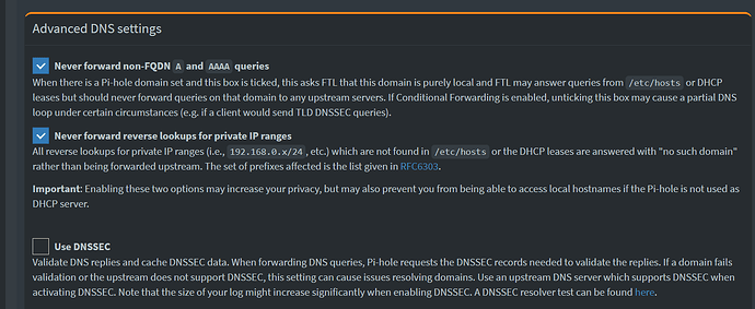

Some aditional settings but still can't get Unbound DNSSEC to work correctly.
grep PIHOLE_DNS /etc/pihole/setupVars.conf
PIHOLE_DNS_1=127.0.0.1#5335

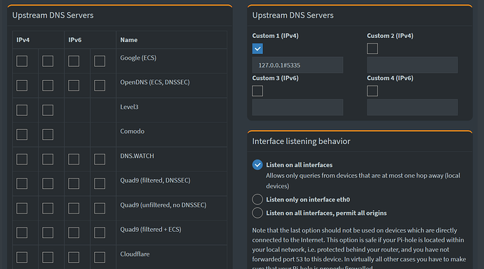

Pi Hole settings
Can I use this for IPv6 for Unbound?
::1/128#5335
This is unrelated to how unbound performs. This tells Pi-hole to use unbound as the upstream DNS server, and that's all.
This is locally served by Pi-hole and not forwarded to unbound for resolution/
No. This setting specifies what DNS server the Pi should use, and is unrelated to the performance of unbound.
Yes, but not in that format and not needed. Unbound can resolve both A and AAAA queries on IPv4 only. There is not need to add an IPv6 address. The existing IPv4 IP will suffice.

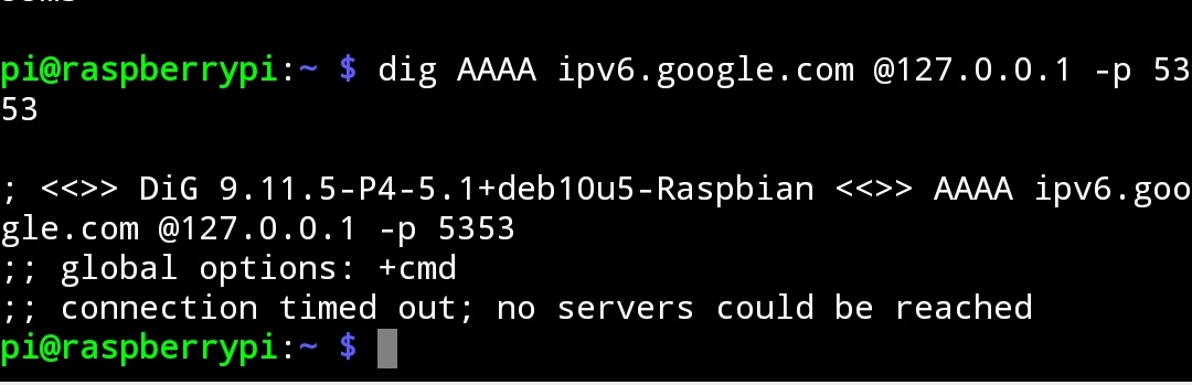

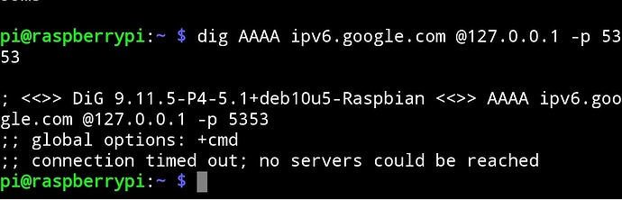

It looks like IPv6 isn't working though :cry:
dig AAAA ipv6.google.com @127.0.0.1 -p 5353
I do have my config file set to: do-ip6: yes
You're not using IPv6 to send that query to unbound. You're using IPv4 (127.0.0.1) and asking for an AAAA record, which is perfectly legal.
Getting a response of 'no servers could be reached' means that unbound is not listening on port 5353 on the localhost interface. Which is highly likely since the guide uses 5335 and not 5353 for the port.
Try your dig again with 5335 instead.

dig again 5335 and everything is working grate. Thank you for the help. I deleated my old posts after this one because the issue was the device and not the pi hole.
