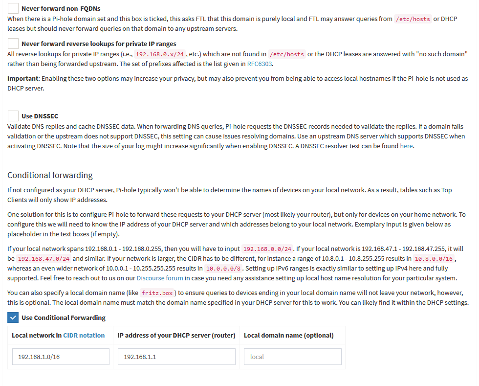

DDNSSec is switched off in Pi Hole.

in Pihole "settings"/DNS: Use DNSSEC is disabled.
It works in my setup. At least this is what https://dnssec.vs.uni-due.de/ reports.
Yes. It's switched off.
